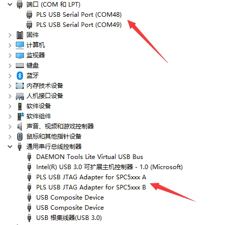

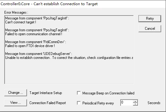

with PLS JTAG and UDE STK 5.2 to debug SPC563M board,i cannot link to the board rightly,why?

how to solve my this problem?   the driver for PLS JTAG looks like normally!

Hello xiong ,
Do you solve your issue ?
Which board do you use ?
Motherboard + Miniboard
or SPC563M-DISP
You have to take the correct flash driver in PLS UDE.
   Best regards
