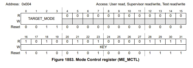

hi community,
           i want to reset the microcontroller "SPC582B60E1". through software. so if anyone know how to reset the MCU using any registers?

Hello ,
you can check
51.4.4 ‘Functional’ resets or 51.4.3 'External' Reset
               Best Regards
                            Erwan

Hi! I haven't used that specific microcontroller before, but there should be a MCTL register in the ME (Mode Entry) module. Setting the target mode field to RESET should trigger a restart of the system. You also have to supply the correct key to make the mode transition valid. All this should be explained in the reference manual.
