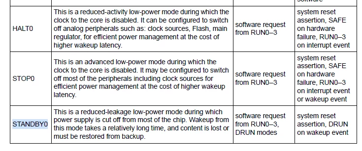

How to wake up from STANDBY0 mode and also Halt0 mode?
Is it possible to wake up or come out of STANDBY0 mode by pressing the reset button on the eval board?
I tried it that way, but it is responding to the reset.
As mentioned in the table above, can a system reset (hardware reset) be used to wake up from HALT0 and STANDBY0 mode?
