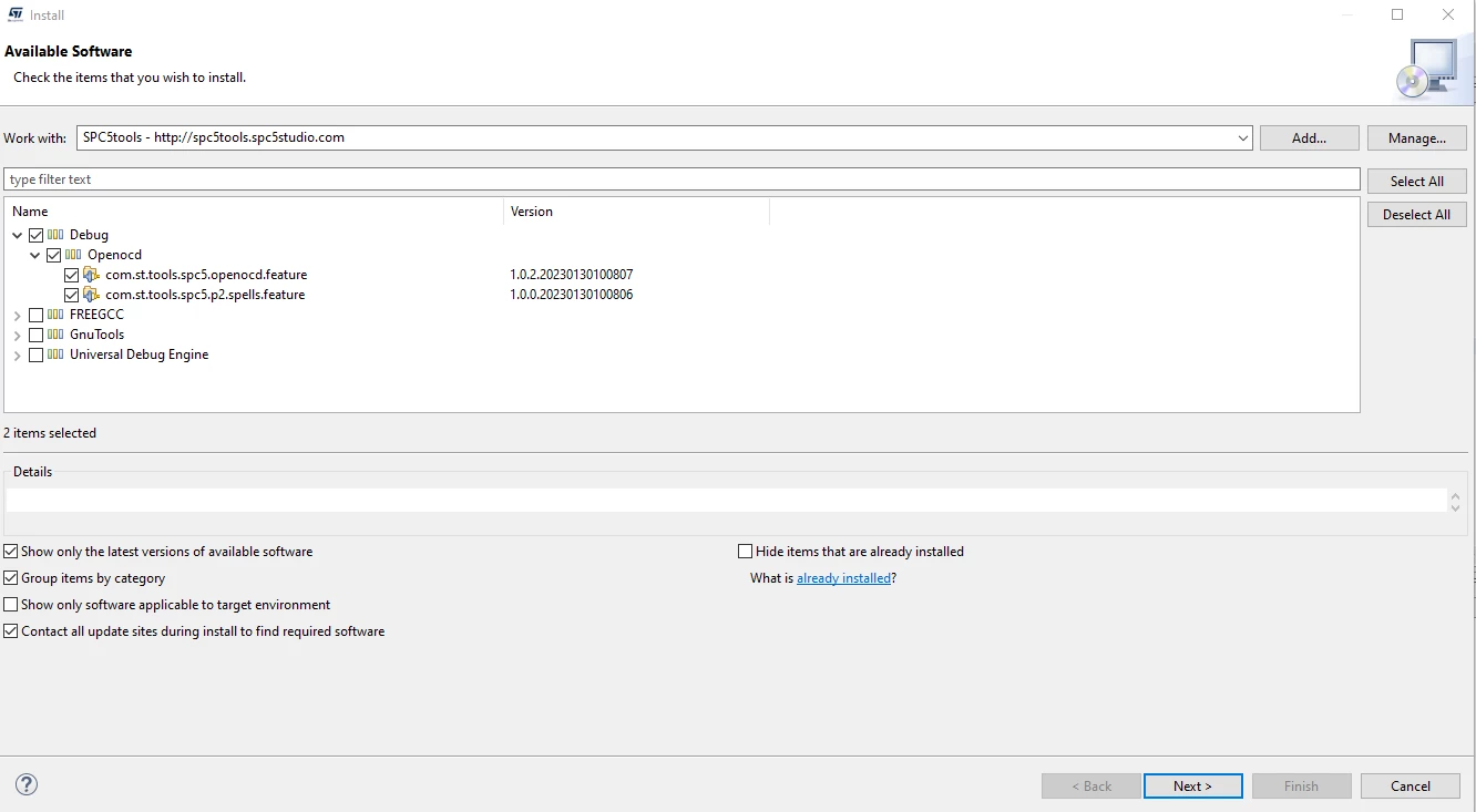

I've been looking for a debugger to debug and program an SPC58xx MCU and I've found you offer both the new Stellarlink and the SPC5-UDESKT. I understand the SPC5-UDESKT requires a licence to be used with the Universal Debug Engine (UDE) which are available as either a year licence or a one-time purchase. I was wondering if I would also need one of these licences to use the Stellarlink with the UDE/SPC5Studio? It looks like the Stellarlink has more features supporting your Stellar Automotive line so would you recommend this for a new debugger/programmer purchase over the SPC5-UDESKT?

    Hello Owen ,
    Yes , we support StellarLink and Openocd on SPC58 Family.
    No need a licence
    In SPC5Studio, Install openocd by update site feature for 58 Family
    Help ==> Install New Software
    http://spc5tools.spc5studio.com
    _legacyfs_online_stmicro_images_0693W00000bjClHQAU.pngCf doc folder
    C:\SPC5Studio-6.0\openocd\docs
    How to use OpenOCD and StellarLink in SPC5Studio.pdf
    Warning : we are using only mono core on SPC58 Family.
