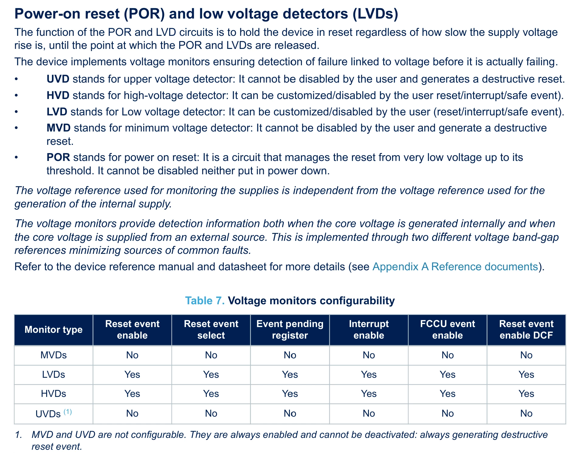

Aug 27, 2026 3:37 AM UTC
Please check the reset/interrupt related voltage setting during your power cycle. It could be lead to software error during power up
