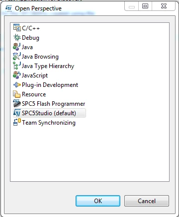

    Could open and reset the eclipse perspective in SPC5Studio ?
    you should recover the Application Wizard
