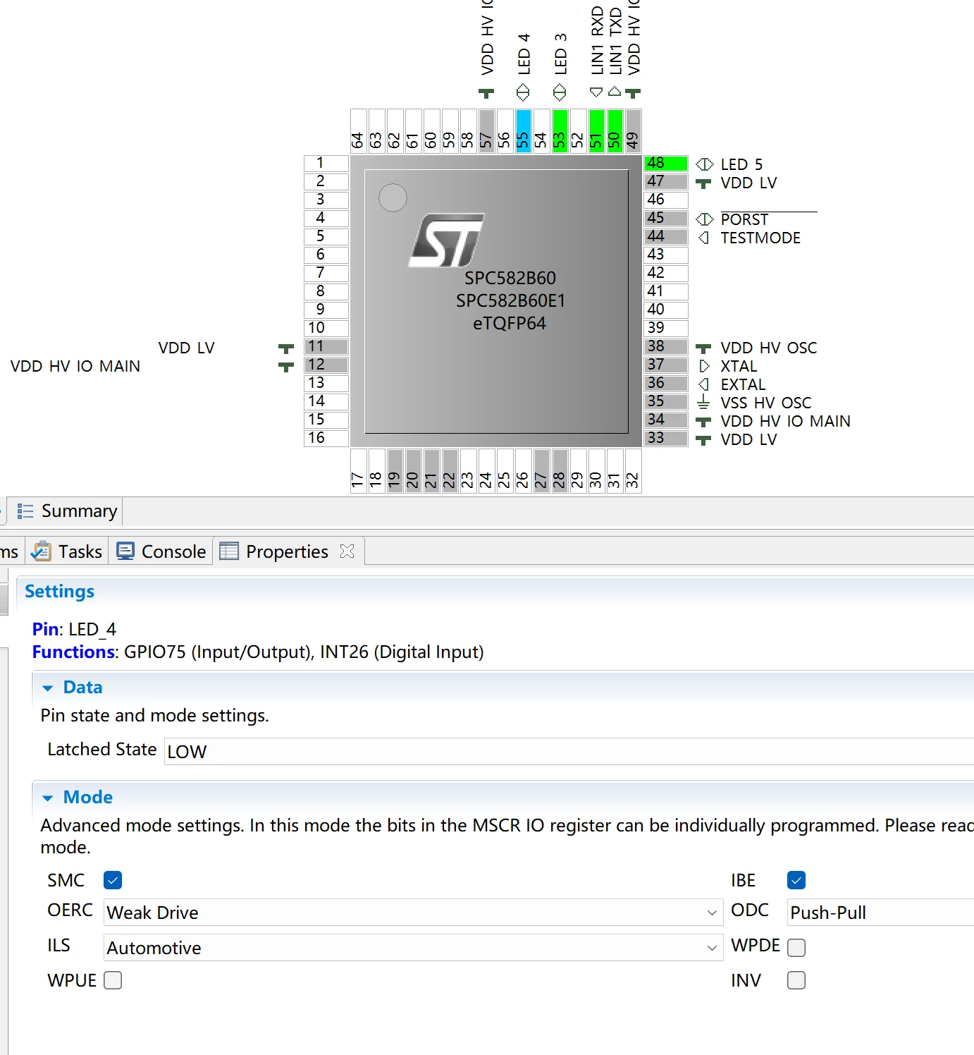

Hi All,
Ok new to SPCSudio and currently using version 6 - have big problems with components  inparticular  PAL.
Basically all the tutorial talk about using PAL to flash an LED or toggle a GPIO pin.
But version 6 appears not to support this!!!
So far everyone is suggesting I move back to SPC5Studio 5.8.1.
So far not impressed with version 6 - Even the AI helps gets it wrong !
Currently just want to toggle some GPIO pins before moving on the CAN stuff,
Currently using the SPC5884B70E5 device and using a SPC584B-DISP dev board to kick off our development.
Hope someone can help
db16122Best answer
Oct 7, 2026 11:47 PM UTC
Maybe you can try example with function as pal_lld_togglepad(PORT_E, LED_4); Pin map editor could be helpful with GPIO setting
