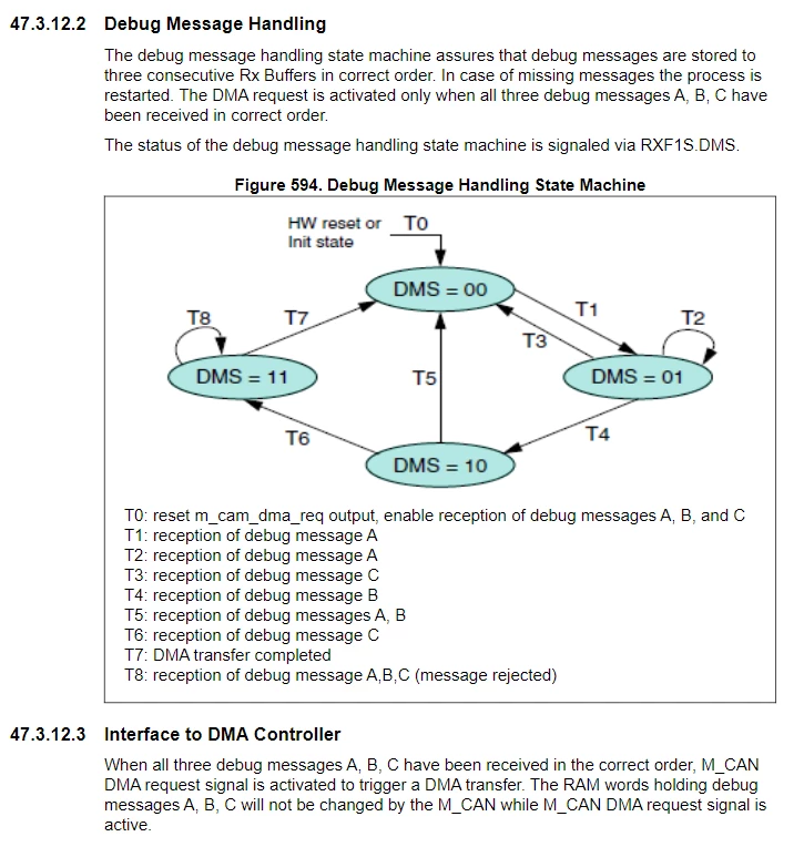

I want to use DMA to transfer messages received from CAN. However, there seems to be no information in the datasheet about this feature, except for the illustration below. According to this image, it seems like using DMA for CAN is a default feature. However, I cannot find any settings related to CAN with DMA in SPC5Studio. Could you provide me with more information on how to use DMA for CAN? Is there any sample program available?Capture.PNG

Sorry , we have not EDMA configuration for CAN in our examples.
