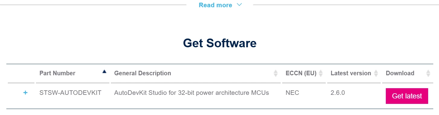

May 9, 2025 9:04 AM UTC
There are, but the latest Autodevkit version does not require any setup.
Just visit this page
Scroll down to the "read more" section and click on the "Get latest" button
Follow the download procedure, then:
1. Uncompress the zip file
2. Launch the .exe file
3. Accept the license
Once installed you can follow the "AutodevKit detailed tutorial series" on youtube, starting from part 2.
Best regards,
AEK_Team

May 31, 2025 8:29 AM UTC
By now I have been trying quite much to get this working.
To me it seems that the original kit version 2.6.0 were missing some content. Though the archieve was extracable.
After my previous post a new version (2.6.1) has been published.
But there is something wrong with the archieve it cannot be extracted.
