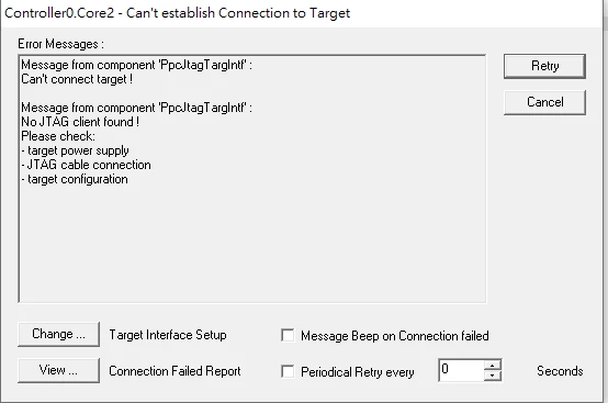

Feb 27, 2024 3:37 AM UTC
Hi FP,
Thank you very much for your response. However, I have been using UDE STK for the programming operation before. In this case, can I still use the method you mentioned to execute a script for the clear operation?
Additionally, I am using the FTDI on the development board. If I don't connect it via USB, it seems that there won't be a connection pipeline with the PC.
Thanks.
device name on my device manager
connect fail on UDE STK

Mar 1, 2024 1:18 AM UTC
Hi FP,
My development board is SPC58EC-DISP, and I encountered a situation similar to Rseba.2 I later successfully installed Openpcd, but I still cannot Flash/Erase the device. Additionally, my development board itself has an independent power supply, so it seems a bit different from your situation. Currently, I am still unable to burn and update the firmware.
Thank you very much for your assistance.
Ethan
FPros.1
Mar 1, 2024 9:04 AM UTC
Hi Ethan,
I had the same openocd fail log (mine had no libusb errors..)
The JTAG seems to respond fine to the driver initially but those libusb errors are a bit suspicious.
Anyway, can you see the JTAG device on Windows without powering the board up (through the independent power supply)?
If yes, I'd try connecting and simultaneously powering the mcu up with the script.
Also, as I mentioned earlier in the thread, my reset led used to do a brief toggle at power up and that could be a rescue opportunity.
Regards,
FP
