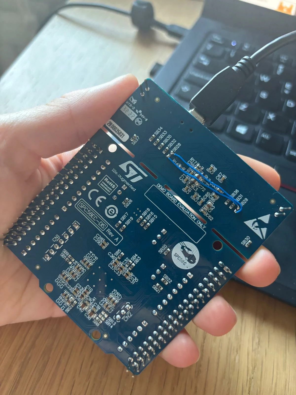

I've just gotten a new microcontroller SPC58EC-DIS from elfa. From my past I worked a lot with STM so I wanted to try something new, but this was the first time that I got something like this:
Is it normal that the board comes with soldered wire between components SB28 and SB29 or is this something that I should report to the supplier?

Hello ,
SB28 and SB29 are opened
SPC58EC-DIS discovery board - User manual (st.com)
Your board seems to be configured
I think that PLS Integrated do not work just External JTAG Programmer
You should put a small resistor in order to activate PLS.
I think that your board is functional.

Jun 25, 2024 3:01 PM UTC
it seems to be hardware patch.
I am checking with board responsible.
