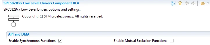

In the timer IRQ handler, I need to invoke SPI spi_lld_exchange API.
Problem is this API doesn't complete, remaining stuck on the while
SPC5_SPI_WAIT_FOR_TXRX_COMPLETION(spip);
SPI APIs are configured synchronous:

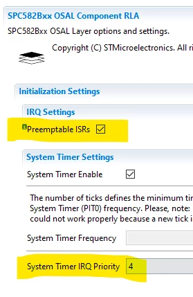

I already activated the preemptable ISR option in the configuration:
Since I don't know if the priority level is ascending or not, I tried both priority situations, that is:
System timer (PIT0 CH0) priority: 4                    DSPI0 priority: 10
System timer (PIT0 CH0) priority: 10                  DSPI0 priority:4

My routine was called inside in a critical section so I just needed to exit temporarily such region (as it was performed in the AutoDevKit SPSB081 example) in order to make the SPI synchronous APIs work.
