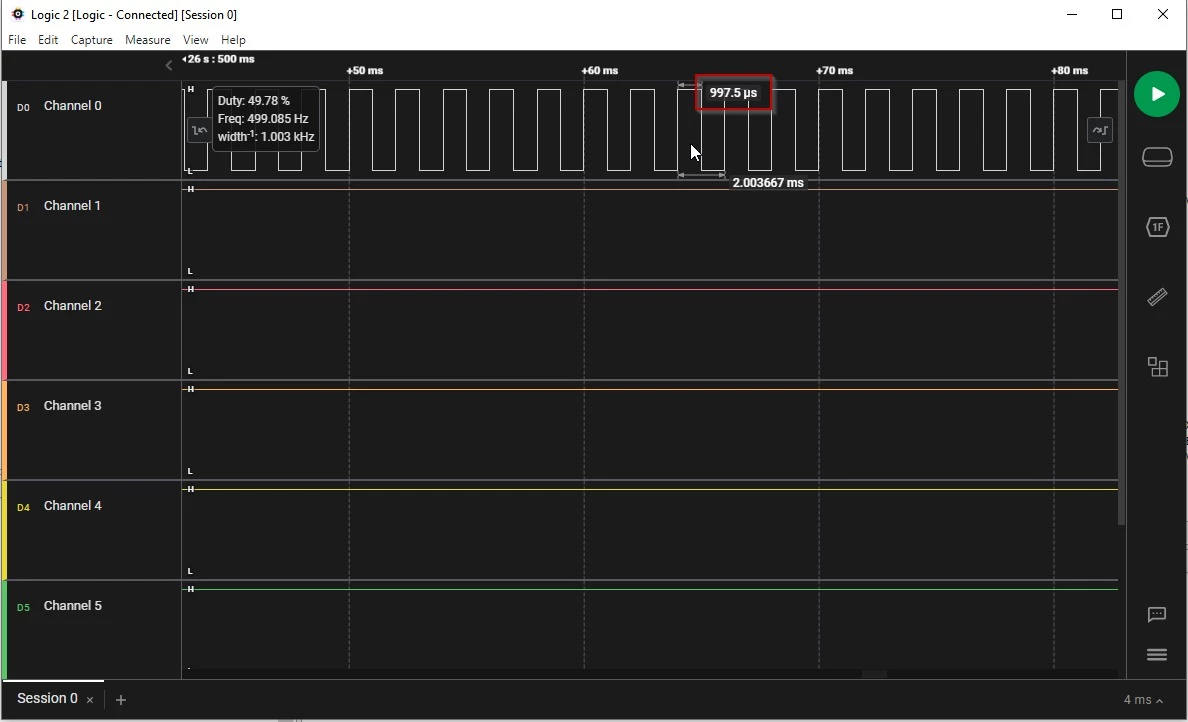

Hi All,
I am working on SPC574S64 Controller
I am using the sample code from the SPC5 Studio
PIT Time which toggles the port for 4ms, 2ms and 1ms
I have also observed one more issue with the crystal, I couldn't see the oscillation but could be my logic analyzer couldn't capture I guess
Today I am seeing a strange issue with my board.
When the debugger is connected to the board, the code is running fine
I could see the port toggling for the timer Interrupts

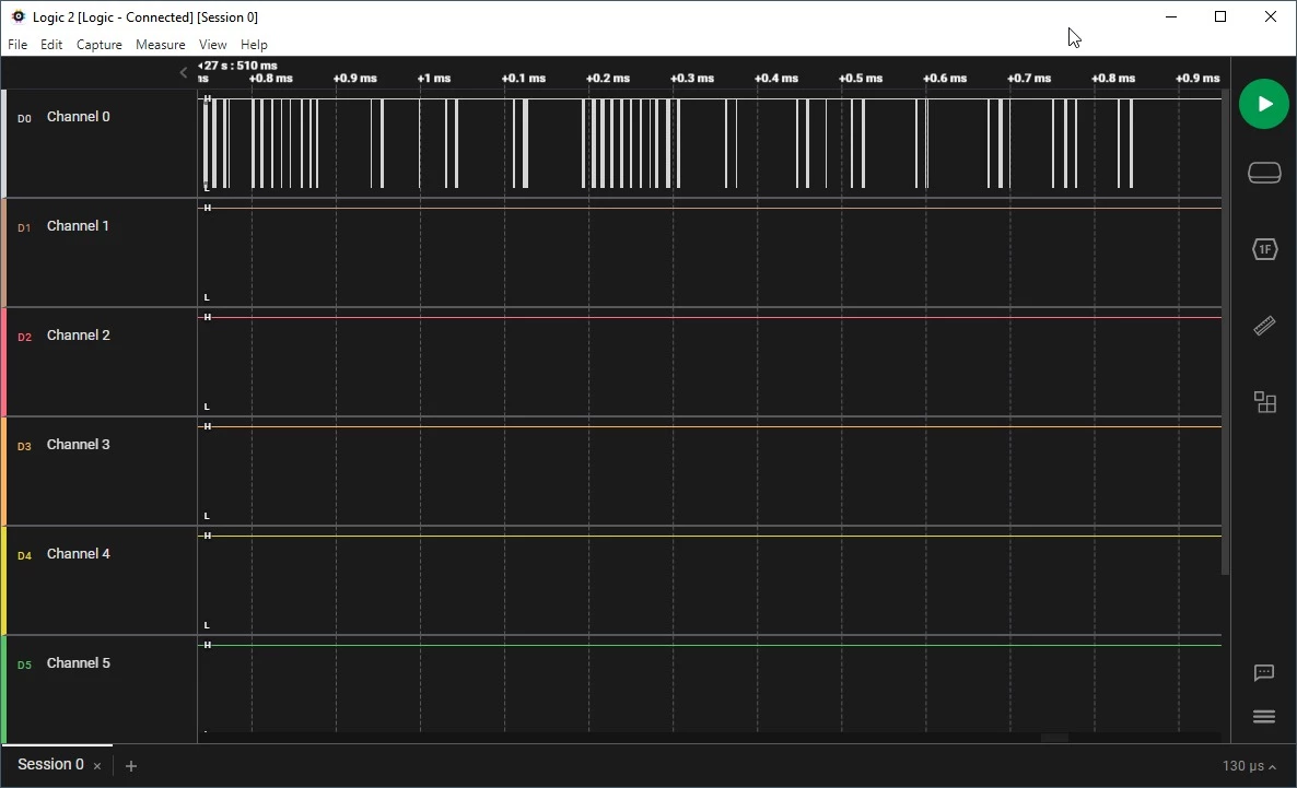

_legacyfs_online_stmicro_images_0693W00000biB6VQAU.pngbut when the debugger is removed the code doesn't run and the port toggling is like random or garbage toggles which are inconsistent
_legacyfs_online_stmicro_images_0693W00000biB6aQAE.png​
I have checked the crystal oscillator​ frequency but I only have a logic analyser which is of 24Ms/sec not sure if it is capable of capturing
I checked with it but I couldn't see the oscillations are proper
Kindly suggest, how to debug this
