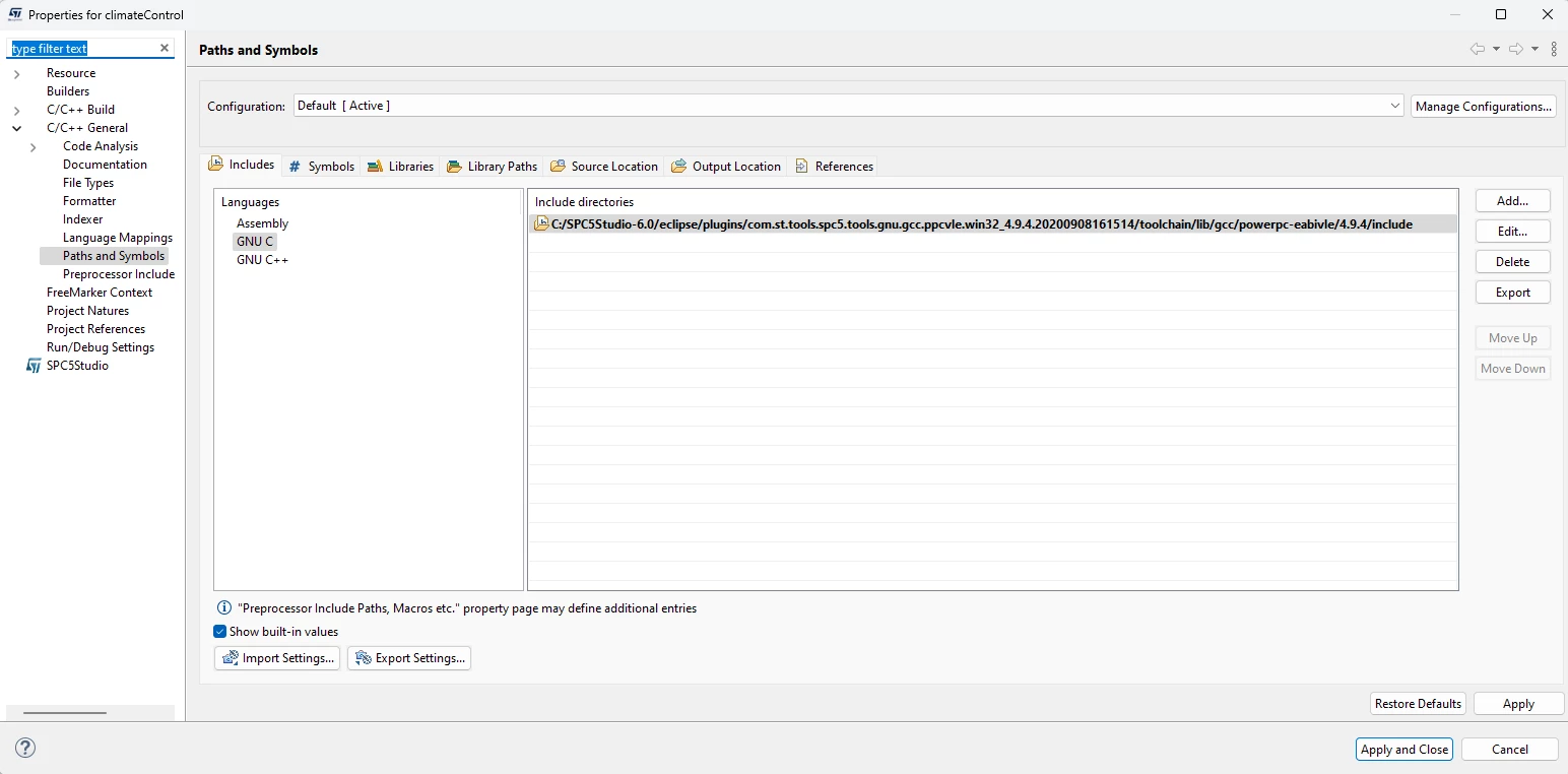

Hi, i am newbee too, but i have solve 'uint32_t, 'uint16_t' 'uint8_t doing:
Right click on SPC5XXXXXTestApplication ->Properties
Under C/C++ General->Path and Symbols
Selec Tab Includes, then GNU C->Add..
write C:\SPC5Studio-6.0\eclipse\plugins\com.st.tools.spc5.tools.gnu.gcc.ppcvle.win32_4.9.4.20200908161514\toolchain\include
I hope help somebody

Hi PChia.2237
I have the include you mentioned, but I still have an error. "Type 'bool' could not be resolved". Asking for includes <stddef.h>,<stdbool.h>.
Looking for any suggestions. Thanks in advance.

Yes, the something with this folder:
C:\SPC5Studio-6.0\eclipse\plugins\com.st.tools.spc5.tools.gnu.gcc.ppcvle.win32_4.9.4.20200908161514\toolchain\lib\gcc\powerpc-eabivle\4.9.4\include
You welcome. The problem is for SPC5 Studio 6. Version 5.8 has no this type of problem.

For others to refer to his solution, you can refer to the below screenshot. |
I added only one directory and it resolved:
C:/SPC5Studio-6.0/eclipse/plugins/com.st.tools.spc5.tools.gnu.gcc.ppcvle.win32_4.9.4.20200908161514/toolchain/lib/gcc/powerpc-eabivle/4.9.4/include
