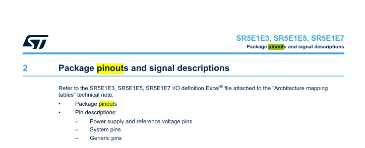

Datasheet says refer Excel Sheet file attached to Architecture mapping table technical note.
Which says as below: Get from excel workbook attached to the SR5E1x IO_Defination document

@sanket471
Exactly there the pinout can also be found. But let's go through it step by step:
  1. Open the product website, go to the Documentation tab
  2. Search for the term "definition" on this website
  3. Find TN1404 and open it with a PDF viewer that can handle attachments
  4. Open the Attachments tab of the PDF viewer and find "SR5E1x-IO_Definition_V4.xlsx"
I hope I was able to help a little with finding the information?
Regards
/Peter
sanket471Author
April 7, 2026
I was using Edge to view pdf. Now I used Adobe pdf viewer and got the excel. Thank you.
