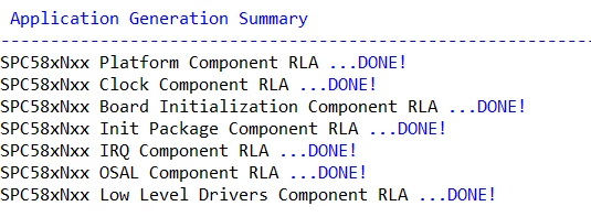

Hello Team,
I am not able to generate the code for the motor control application for SPC58NN board using SPC5 Studio.
Please find the below snapshot of the same.
Its generating the rest of the components except the motor control
Erwan YVIN
Erwan YVINBest answer
Feb 28, 2024 4:11 PM UTC
Same answer as :
https://community.st.com/t5/microcontrollers/not-able-to-generate-the-motor-control-for-the-spc58nn/td-p/641242
you have some nice examples in SPC5Studio Tools Suite
https://www.st.com/en/development-tools/spc5-studio.html
and
Help ==> Install New Software https//mctk.spc5studio.com
              Best regards
                      Erwan
