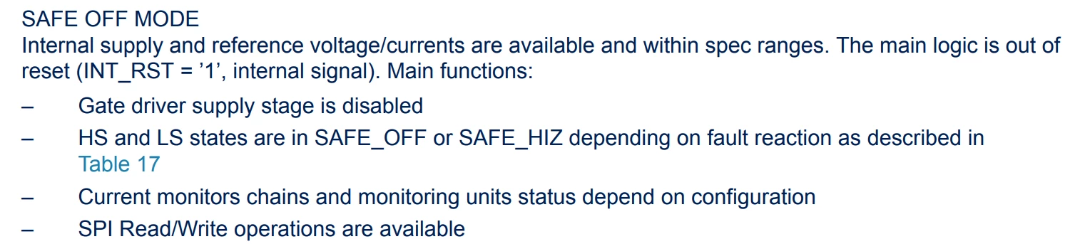

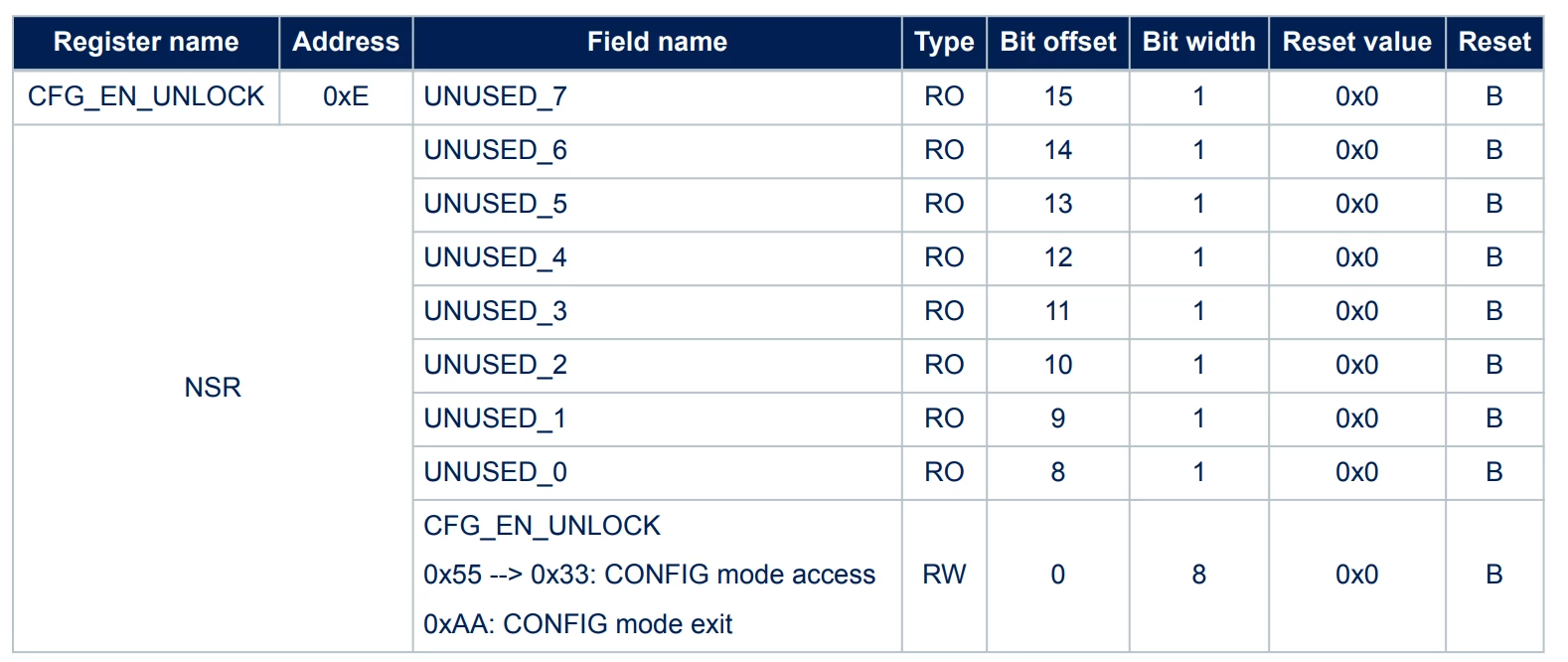

Hello, I would like to ask how the L9908 chip enters the normal mode. I now read the register status, saying that I am in safe off mode, and the config unlock register cannot write values, the rest of the NSR registers can be read and written.
