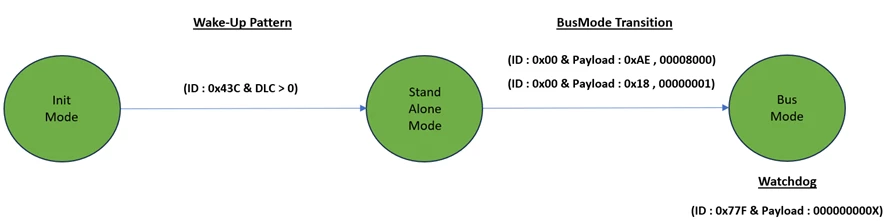

I have designed a L99LDLH32 custom board with two drivers using the schematic shown in the following User Manual: um2996-32channel-led-driver-with-automotive-can-fd-light-interface-stmicroelectronics attached in the ST website: https://www.st.com/en/automotive-analog-and-power/l99ldlh32.html#documentation
I have done different test with the PCB sending CAN FD Light frames and using Din pin to start the drivers. 3v3 and 5v are in the testpoints but I don't receive ACK in any moment and I have not achieved to configure any output pin. I have the CS pin unconnected.
This is the process I'm doing with CAN FD light to get communication but unsuccessfully.
Could you explain me in detail the communication process or what can be my mistake?
Thanks in advance
