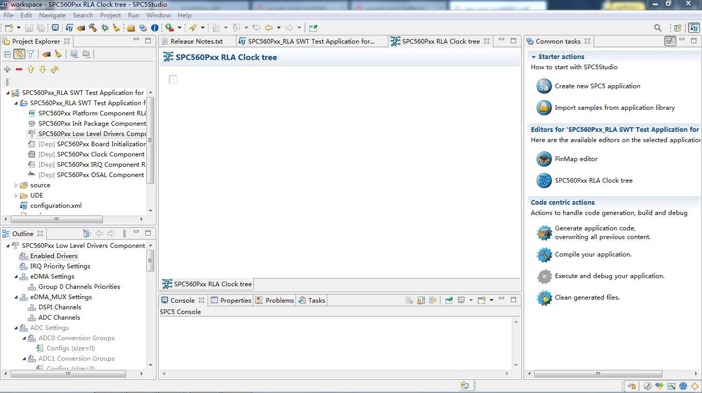

I installed SPC5Studio software, but the Clock tree cannot be displayed!
  • April 21, 2023
  • 25 replies
  • 6223 views
Even after restarting the computer, it won't work, and even if the software is reinstalled, it won't work!

Bwang.3
Bwang.3Author
April 21, 2023
I am using SPC560P MCU !

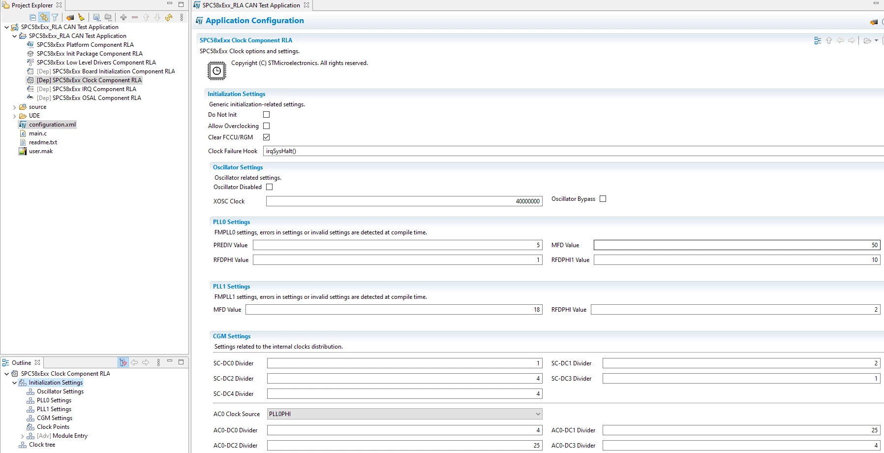

We do not have graphical clock tree for these 3 products:
SPC572Lxx
SPC574Sxx
SPC58xExx
But you can configure with the textual clock component:

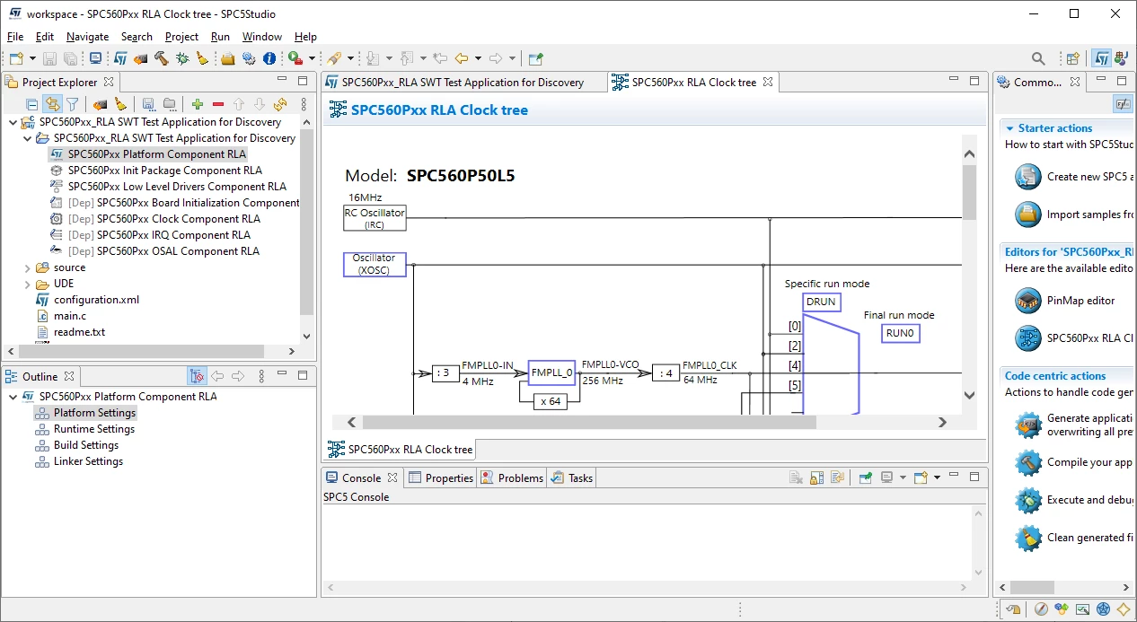

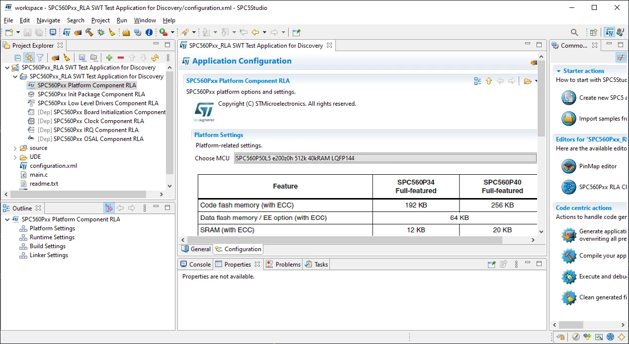

ODOUV.1
April 21, 2023
_legacyfs_online_stmicro_images_0693W00000biatwQAA.pngDo you have same MCU than me ?

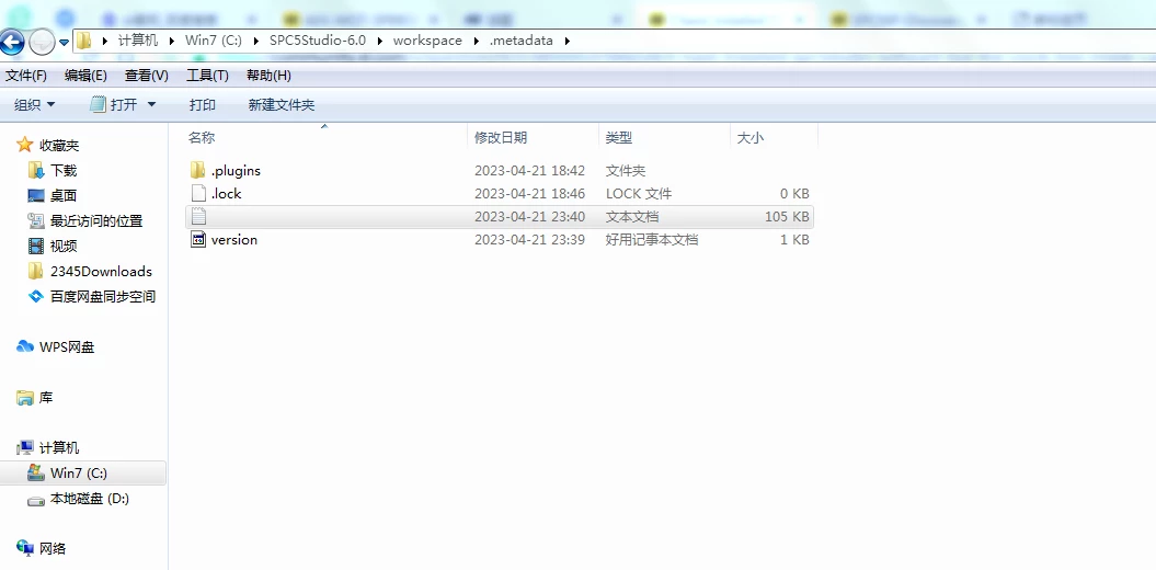

ODOUV.1
April 21, 2023
it is because you do not display file extension
you have "version.ini" displayed as "version" 1KB
and ".log" displayed as icon 105 KB
please send me the 105 KB file, it is your ".log"
