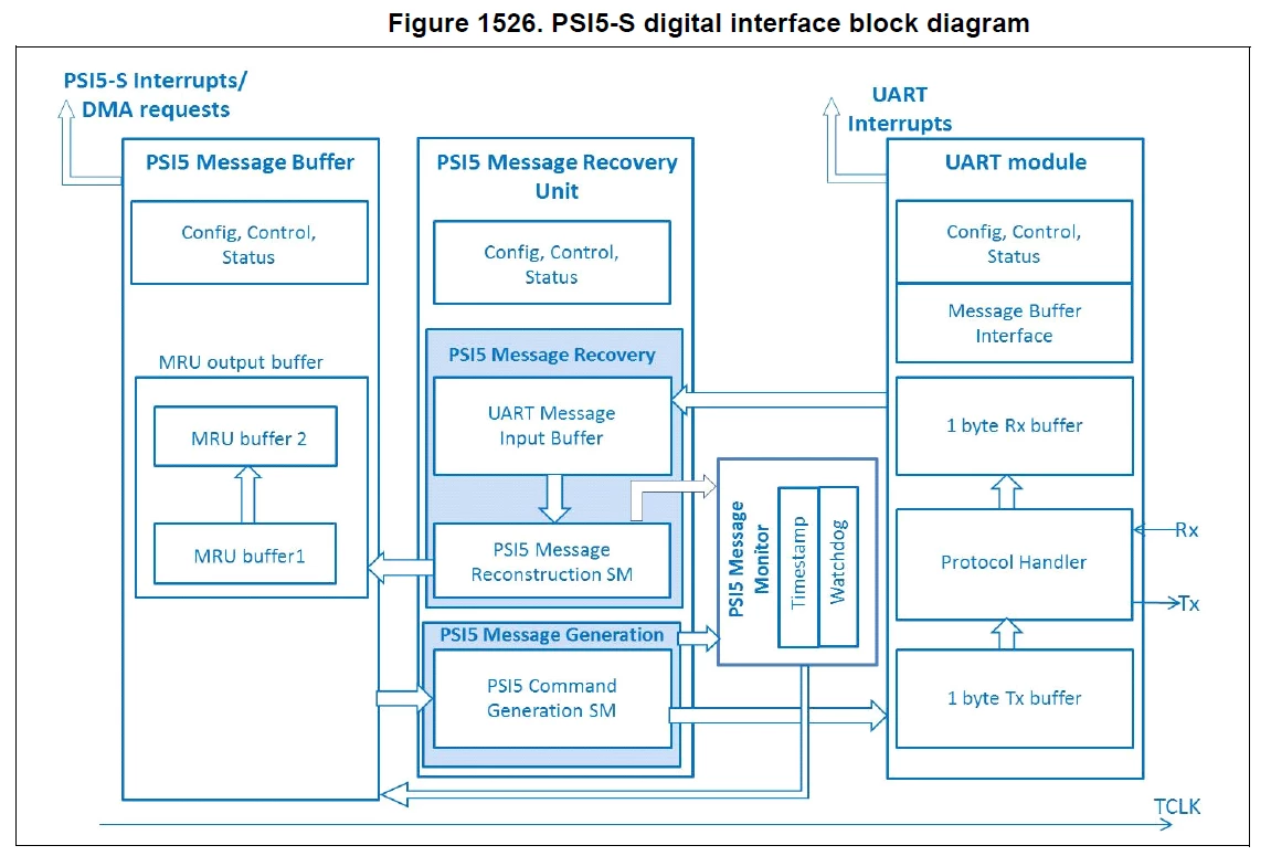

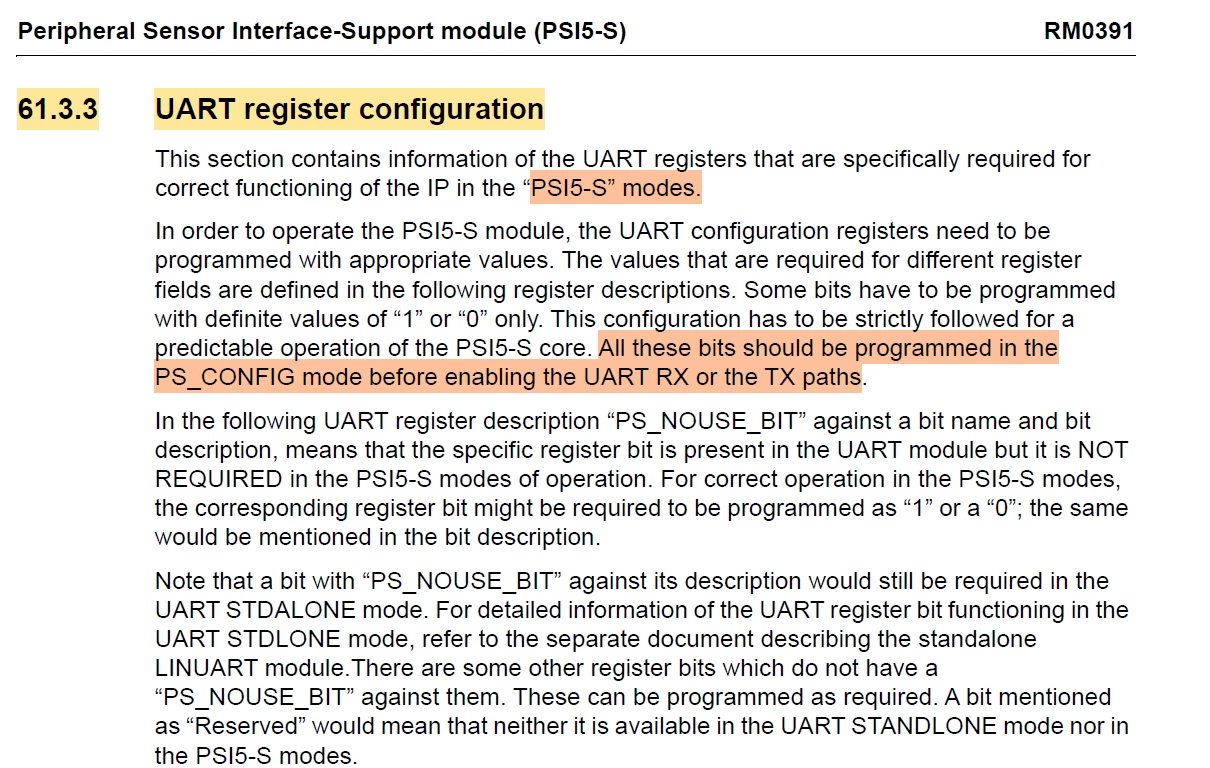

I am currently developing UART functionality on the SPC58EG chip, and I want to use LinFlexD1 hardware channel to develop UART.
However, I cannot find relevant examples in the SPC5 Studio IDE.
I am referring to the official manual (RM0391), which mentions that the Peripheral Sensor Interface-Support module (PSI5-S) must be enabled and related registers modified to use LinFlexD as UART.
Are there any more specific example codes or projects that can be used as a reference for developing UART?

Hello Fukai ,
There is no specific example for the IP PSI5-S modes.
I recommend to fork serial_lld.c in SPC5Studio
           Best regards
                      Erwan
