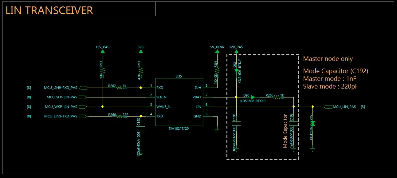

I am using SPC584B70 and LIN transceiver(TJA1021T) for LIN communication and I have a question.
TJA1021T
I need to create a break signal first for LIN
communication but I don't know how to create this signal in the current library.
The current structure is to pass serial data to the TJA1021T chip, and the chip converts it to a LIN signal and sends it to me.
The library I am currently using is serial_lld.c and I have checked that Tx and Rx work fine using this library.

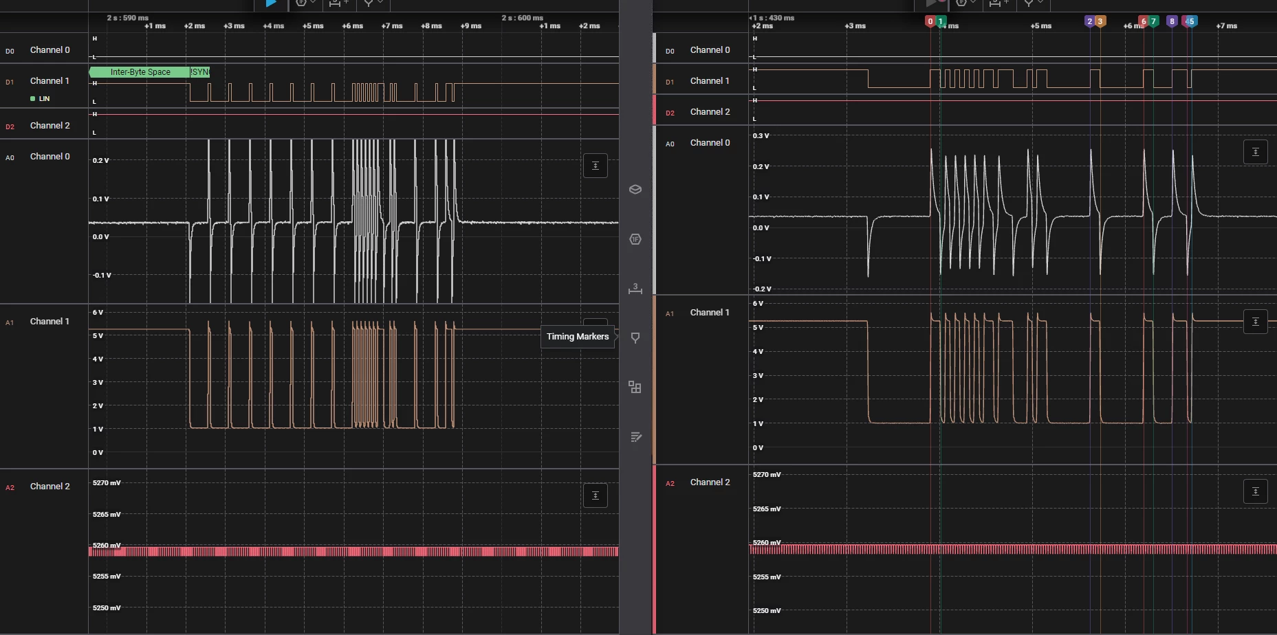

The signal on the left is the signal generated, and the signal on the right is the signal you want to make. This photo proves that Tx is doing well.
* Is there any way to generate and send a break signal using this library?
