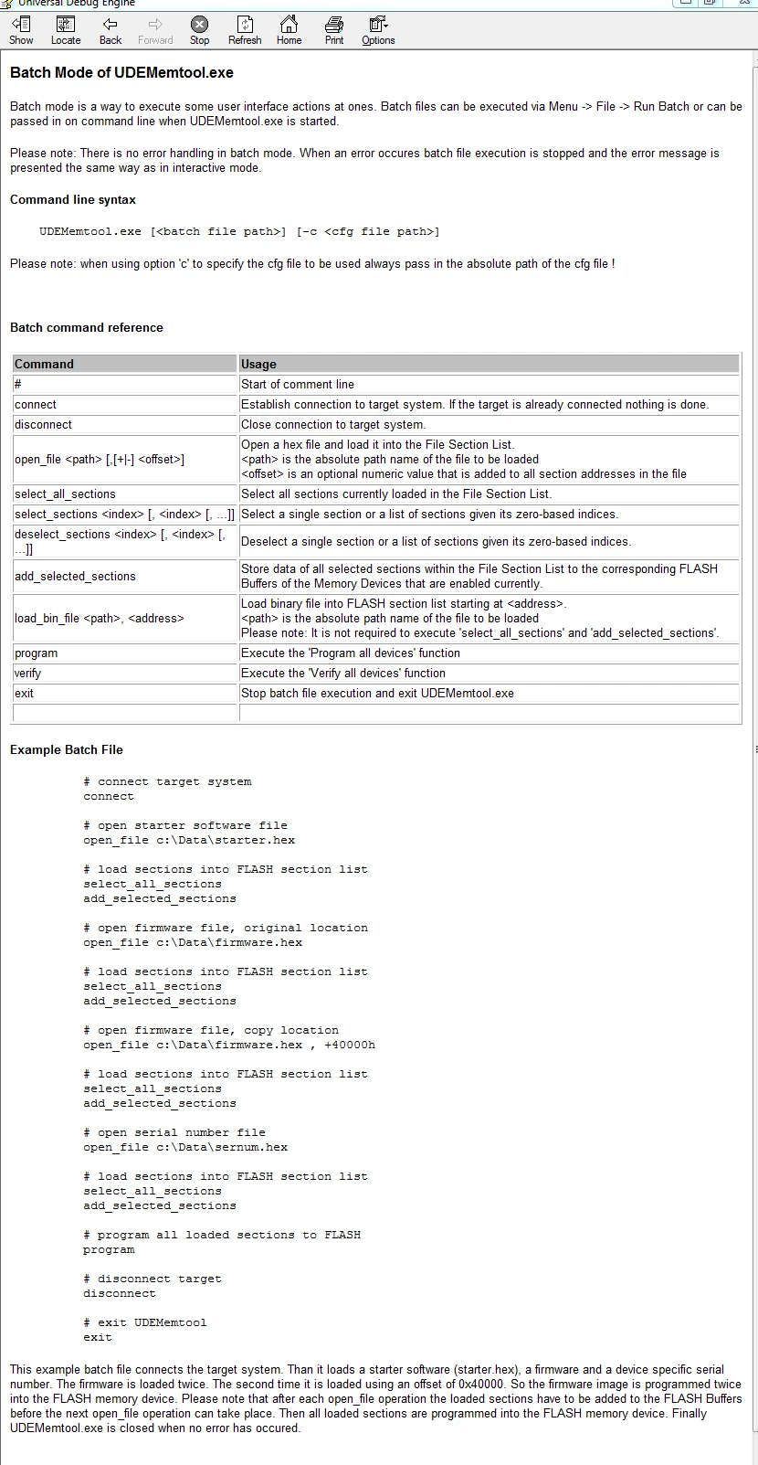

How I can flash spc5x MCUs from command line using SPC5-UDESTK programmer?
Posted on March 05, 2018 at 10:30
I want automate test procedures. How I can flash spc5x MCUs from command line using SPC5-UDESTK programmer?
    Erwan YVIN
    Erwan YVINBest answer
    Mar 6, 2018 10:17 AM UTC
    Posted on March 06, 2018 at 11:17
    Hello Vladimir ,
    you can UDEMemtool.exe in Batch mode cf screenshot
    We have in our company some automatic tests benchs with Continuous integration.
    i will ask to the right person.
                   Best regards
                                Erwan
