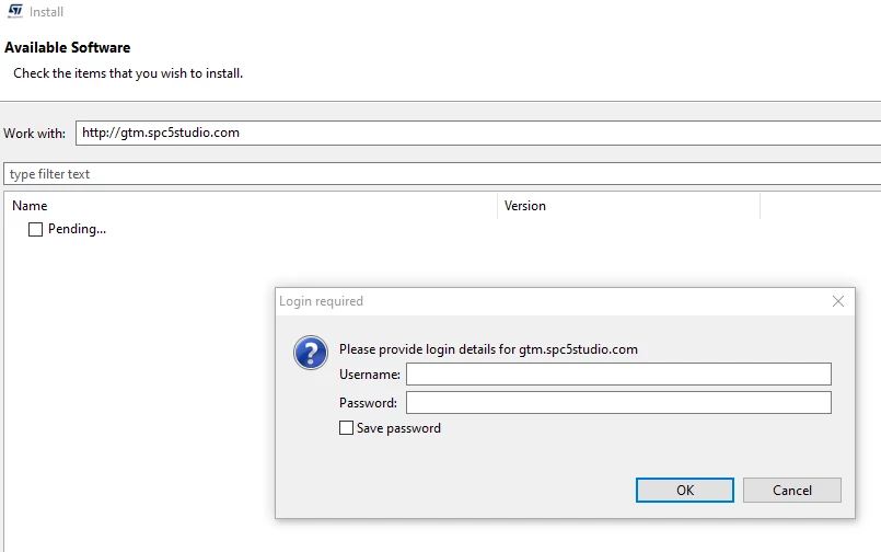

How do I apply for premium credentials for GTM and MCTK?
Erwan YVIN
Erwan YVINBest answer
May 2, 2023 9:28 AM UTC
Hello Scott ,
In SPC5Studio ,
Menu Help ==> Install new Software
Choose the Update Site
you can put the credentials in :
http://gtm.spc5studio.com
http://mctkcust.spc5studio.com
Do not forget the proxy settings
Best regards
Erwan
