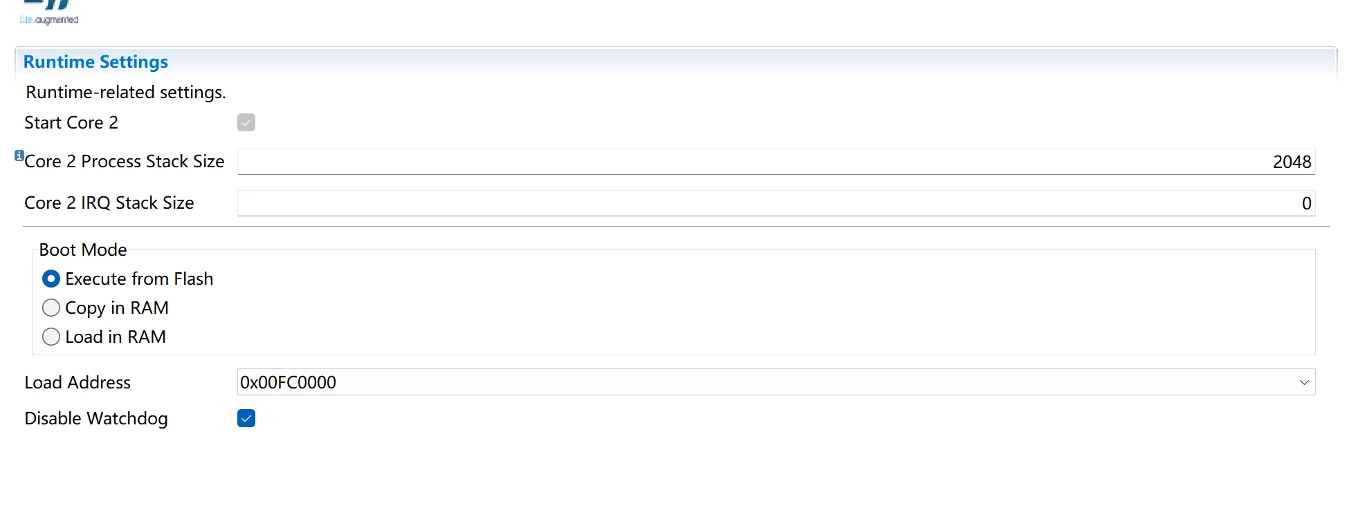

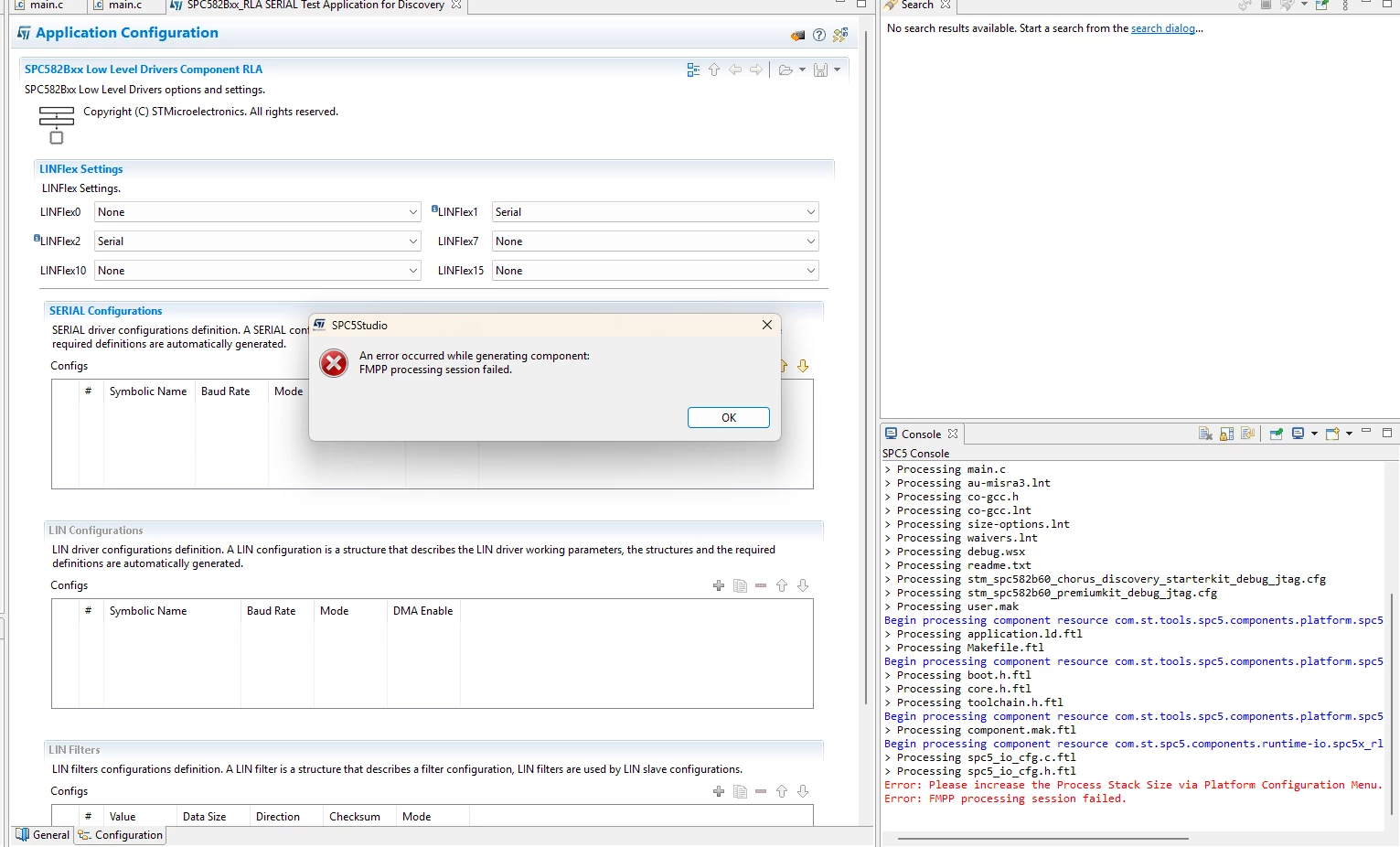

The process stack size may need to be changed. Looks good from my side

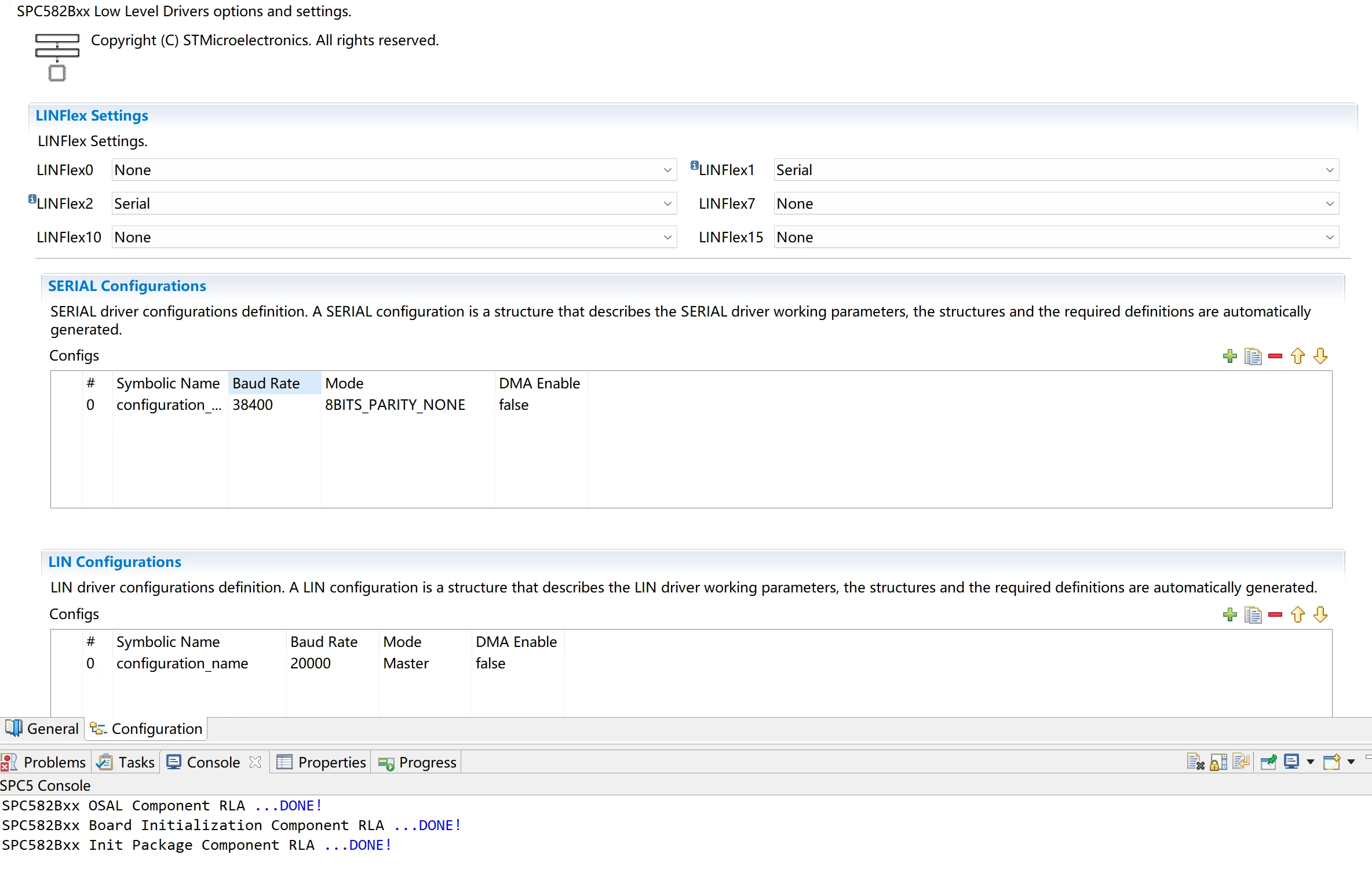

asfakmAuthor
Oct 29, 2026 5:39 AM UTC
Thank you , it was done.
