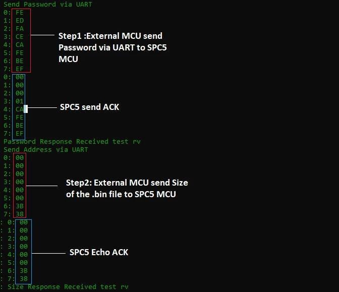

Hi Guys, I am working on SPC584B-DISP Board.In this board i need bootloader option so that i am try to use example SPC584Bxx_RLA Bootloader Test Application for Discovery 2 .In this example download code from serial UART .
In this I can able to download bin file from UART next step jump to app in this step not working if any one have idea please help .......

    Hi sir,
    SPC584B LIN6 TXD D11 => RX on other MCU host
    SPC584B LIN6 RXD D2 => TX on other MCU host
    Yes sir I connected this LIN6 only. big 4*37 connector X9 D1 and D11 pin connected to other MCU.
    Thanks
    Ravi.S

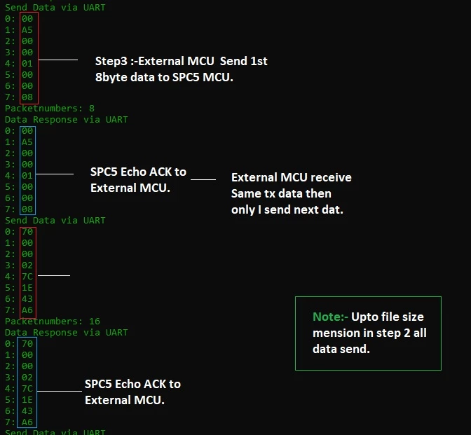

    ODOUV.1
    Mar 17, 2022 2:01 PM UTC
    I just have a little doubt on LIN6 because usually we use LIN4 or LIN0
    but as you said, as you can send and receive data over LIN6 between SPC5 and HOST, LIN6 is maybe not the issue.
    Data must be sent 64bit by 64bit
    each time host is sending data, he must check he received the same data back
    let see...

    Hi sir,
    I print data send from External MCU and send screenshot for your reference.
    Host MCU send 8byte at a time
    Thanks
    Ravi.S
