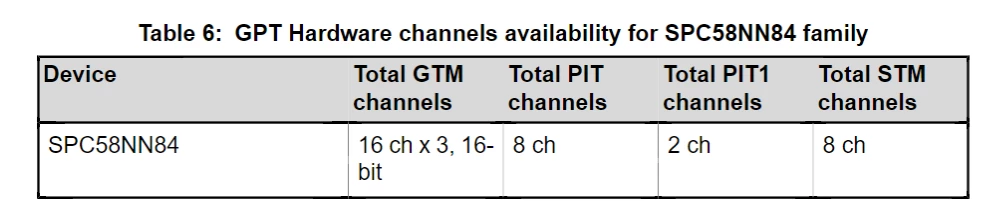

I am currently working on configuring the GPT (General Purpose Timer) MCAL module for the SPC58NN84 microcontroller. While I have successfully configured PIT channels 0 and 1 for my project, I am encountering an error related to RTC (Real-Time Clock) channels during compilation.
Error Message:
In file included from C:/STMicroelectronics/SPC58XE-Nxx_MCAL40_101_Signed/Gpt_TS_T2D42M10I1R0/src/Gpt_NonASR.c:79:0:
C:/STMicroelectronics/SPC58XE-Nxx_MCAL40_101_Signed/Gpt_TS_T2D42M10I1R0/include/Gpt_LLD.h:386:52: error: 'GPT_RTC_CHAN_NUM' undeclared here (not in a function)
extern VAR(uint8, GPT_VAR) GPT_LLD_RTC_HardwareMap[GPT_RTC_CHAN_NUM];
Findings:
- No RTC channel
- Upon investigation, I found that the SPC58NN84 microcontroller does not have an RTC channel available for configuration. The generated configuration file (Gpt_Cfg.h)
defines:/* FOR GTM PIT STM RTC */
* @brief The number of STM HW channels
#define GPT_STM_CHAN_NUM 12U/**
* @brief The number of PIT HW channels
#define GPT_PIT_CHAN_NUM 9
* @brief The number of GTM HW channels
#define GPT_GTM_CHAN_NUM 48 - There is no mention of any RTC channels.
- Configuration Tool:
- While configuring the GPT channels using the EB tresos tool, I noticed that options for RTC channels were absent, confirming that they are not supported on this microcontroller.
Given these findings, I would like to ask the community for guidance on how to resolve the compilation error related to GPT_RTC_CHAN_NUM.
