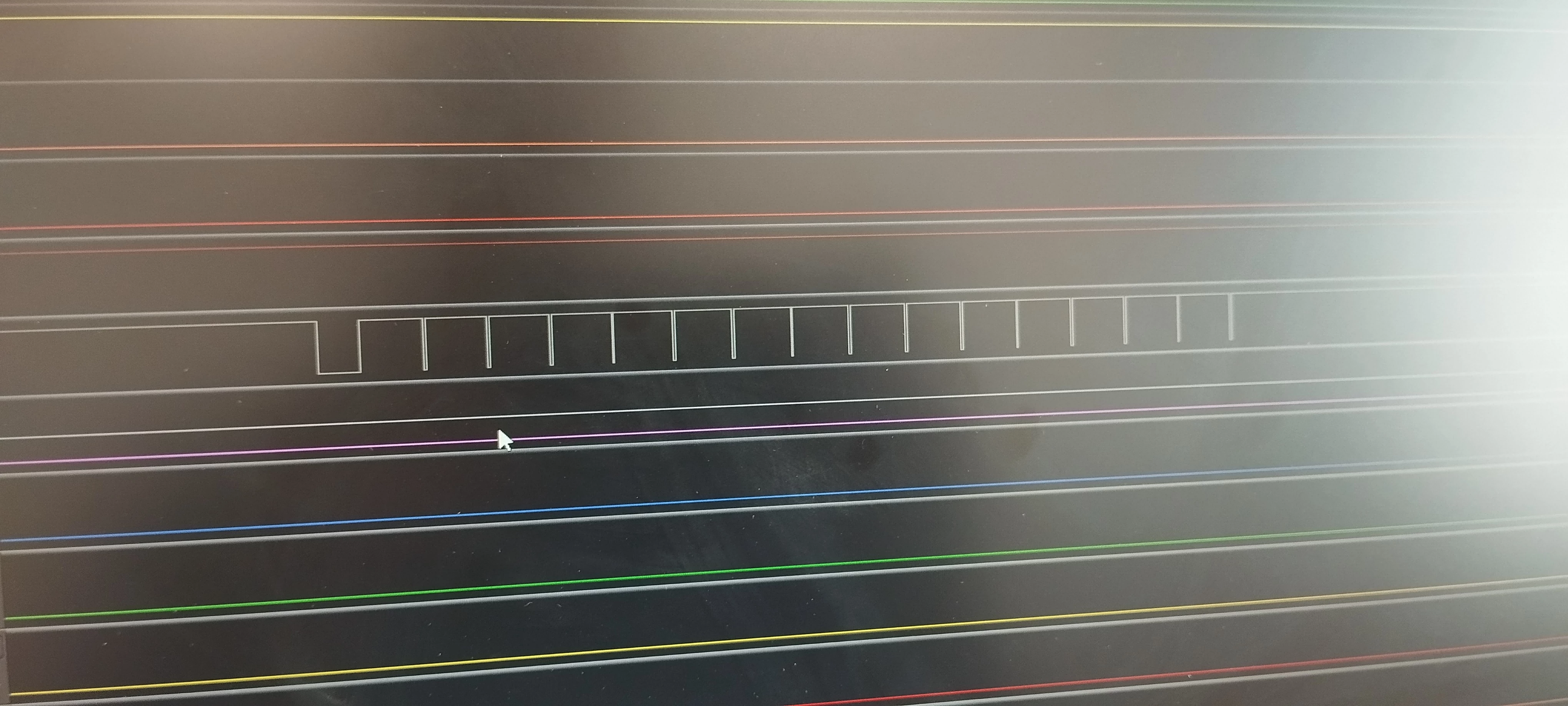

Hello
I'm working with SPC560P40 and I tried to send CAN data but with any condition which I tried out, it has just some regular pulses that has no meaning. I saw all examples in SPC5Studio but I got same pulses. would you please help me out with this problem.
Thanks for your attention

1-> Set with Pin Map Editor: Digital Output CANTXD0 pin and Digital Input CAN0RXD pin
2->In Low Level Drivers Component RLA:
    2A->Enable Drivers: Flag CAN
    2B->In FlexCan Settings Enable CAN0, set filter and timing
    2C: Clik on Generate SPC5 Application
3->In main.c add #include "can_lld_cfg.h"
componentsInit();
irqIsrEnable();
can_lld_start(&CAND1, &can_config_name_of_your_config);
and in while loop to send somethings:
while(true){
txmsg1.data8[0]=21;
txmsg1.LENGTH = 1;
txmsg1.IDE= CAN_IDE_STD;
txmsg1.SID = 123;
txmsg1.RTR = CAN_RTR_DATA;
can_lld_transmit(&CAND1, 1, &txmsg1);
osalThreadDelayMilliseconds(100);
4->Build and test

Hello
Thanks for your quick response, I tried out these codes and configures but the issues is still remaining. About the timing, based on formula for Bit Rate in this section, I tried to set the Bit Rate to 500kbs as the SYS_CLK is 64 MHz and XOSC_CLK is 16 MHz, how should I set PROPSEG, PSEG1, PSEG2 AND PRESDIV?
Thank you
September 6, 2023
set
-PROSEG=4
-PSEG2=1
-PSEG1=7
then try two value of PRESDIV: 3 or 7

Hello
Actually I tried them but it still has meaning less signals. Then I checked out board initialization component parts and pin identifier, I saw it has warning and says pin name must be unique! So would you please help me out with this.
Thanks again
September 8, 2023
post the pin map pic.
Chek pin name, i seams two pins have same name.
