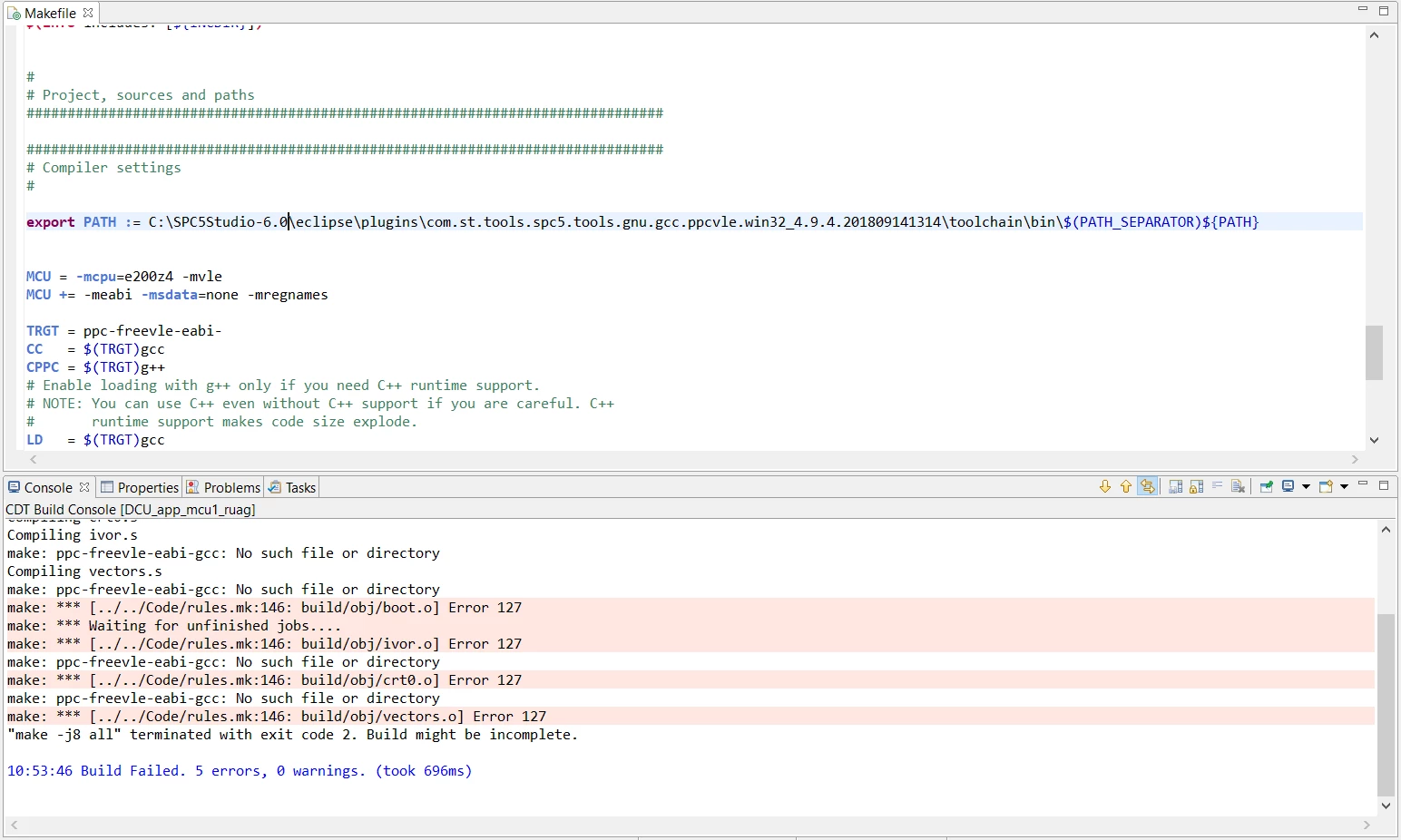

Facing this error While trying to build a project on SPC5 Studio "make: ppc-freevle-eabi-gcc: No such file or directory" Knowing that it exist in the SPC5 Studio plugins
_legacyfs_online_stmicro_images_0693W00000bkdxvQAA.pngthis is the path in the make file and the path is written correctly

    The gcc path is added at compilation time thanks to this line in Makefile:
    export PATH := C:\SPC5Studio-6.0\eclipse\plugins\com.st.tools.spc5.tools.gnu.gcc.ppcvle.win32_4.9.4.20200908161514\toolchain\bin\$(PATH_SEPARATOR)${PATH}

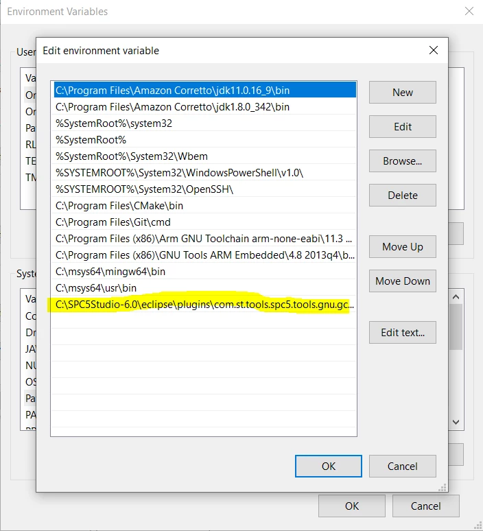

    can you try to add it manually in your path ? using windows environment settings ?
    AAsho.2
    AAsho.2Author
    May 23, 2023 10:32 AM UTC
    Tried this and still the same error

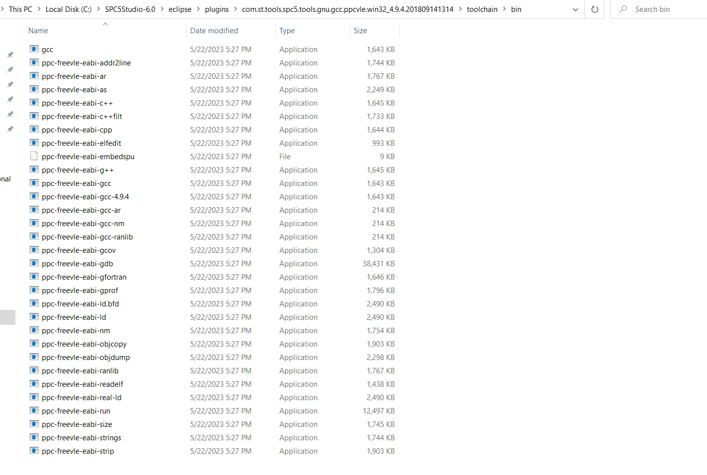

    Normaly we are using the version C:\SPC5Studio-6.0\eclipse\plugins\com.st.tools.spc5.tools.gnu.gcc.ppcvle.win32_4.9.4.20200908161514\toolchain\bin
    i suspect that that your toolchain has been removed or is obsolete
