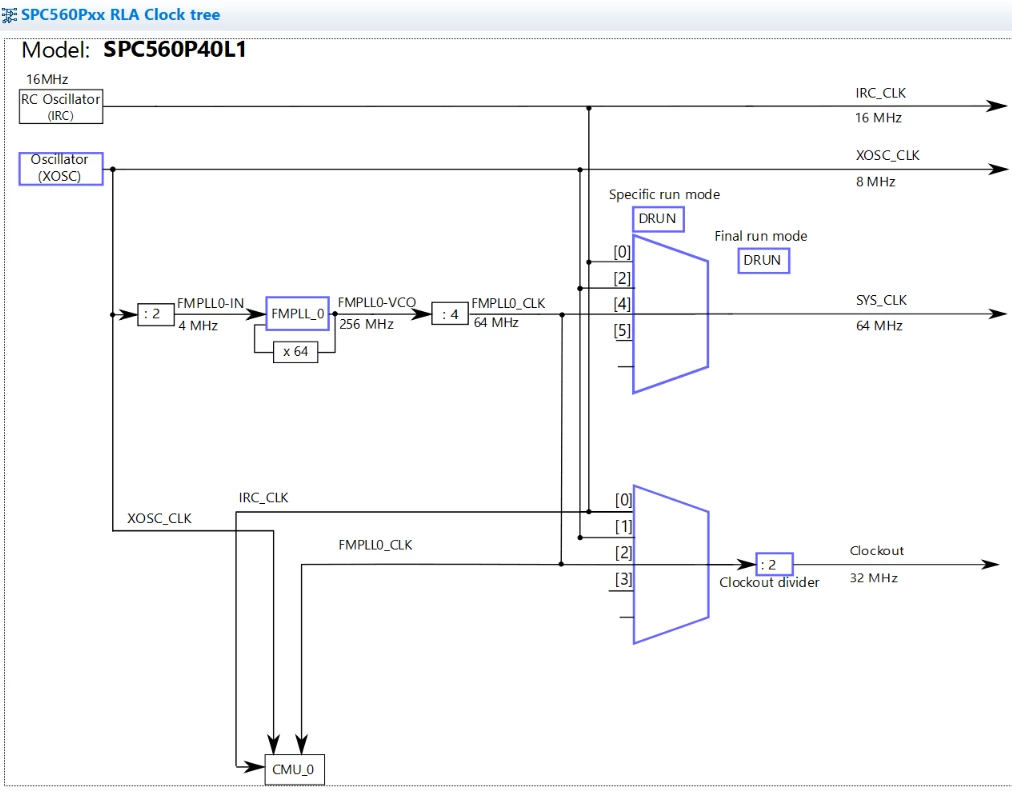

Hello Dear Forum members,
This question is regarding SPC560P40L1 controller's eTimer module.
At the moment my eTimer module using 'IP Bus clock' which is of 64M Hz. I am using prescaler value of '32' to get 2M Hz to eTimer module.
I want to have clock frequency of 20M Hz(or 40M Hz or multiples of 20M Hz basically).
I see in the block diagram of technical datasheet that(Please see attachments) there is option to choose from clock sources: 'Clock' or 'IP Bus clock'
The crystal oscillator frequency is 40M Hz. I would like to use this frequency as input to my eTimer module but i don't know how or even it's possible to get this Frequency routed to eTimer ?
I would be happy if someone can share any useful tips or suggestion in this regard.
Best regards
Sathish

    Hello Sathish ,
    The RM is not clear in the clock domain
    if you want to configure correctly,
    It is a good thing to use the clocktree in SPC5Studio Tools Suite.
      Best regards
                 Erwan

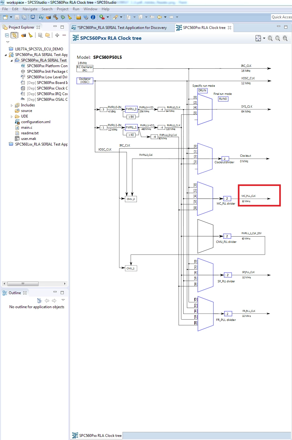

    Dear Erwan,
    Thank you for your reply.
    In my project clock tree(Please see attachment) i do not see clock selection logic block for ''MC_PLL_CLK''.
    Please let me know how could i add this block and how do i route this(MC_PLL_CLK) to eTimer module instead of  SYS_CLK with Prescaler 0690X0000060ACzQAM.png?
    Freundliche Grüßen
    Sathish

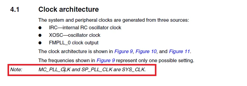

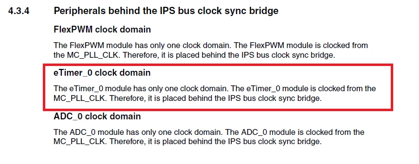

    Hello Sathish,
    for P40 Family, you should take SYS_CLK.
    the clocktree is well valid (cf below)
    The RM is a game of investigation ;)
      best regards
