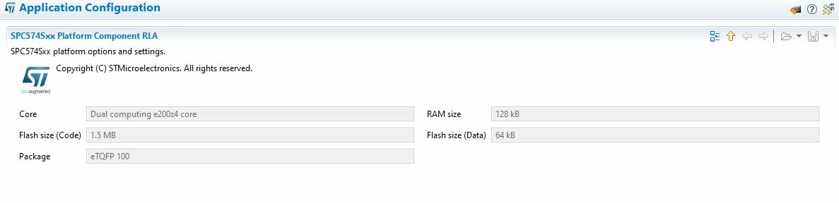

I have been using the Eval L9963e board where i have SPC5764E3 ,Here in the below picture it is selected as Dual computing e200z4 core but i want to use one core the option is disabled can anyone give me the solution to this problem

Hello ,
We have not implemented multicore configuration in SPC57
I recommend to check SPC58 examples in SPC5studio toolsuite
           Best regards
                        Erwan
