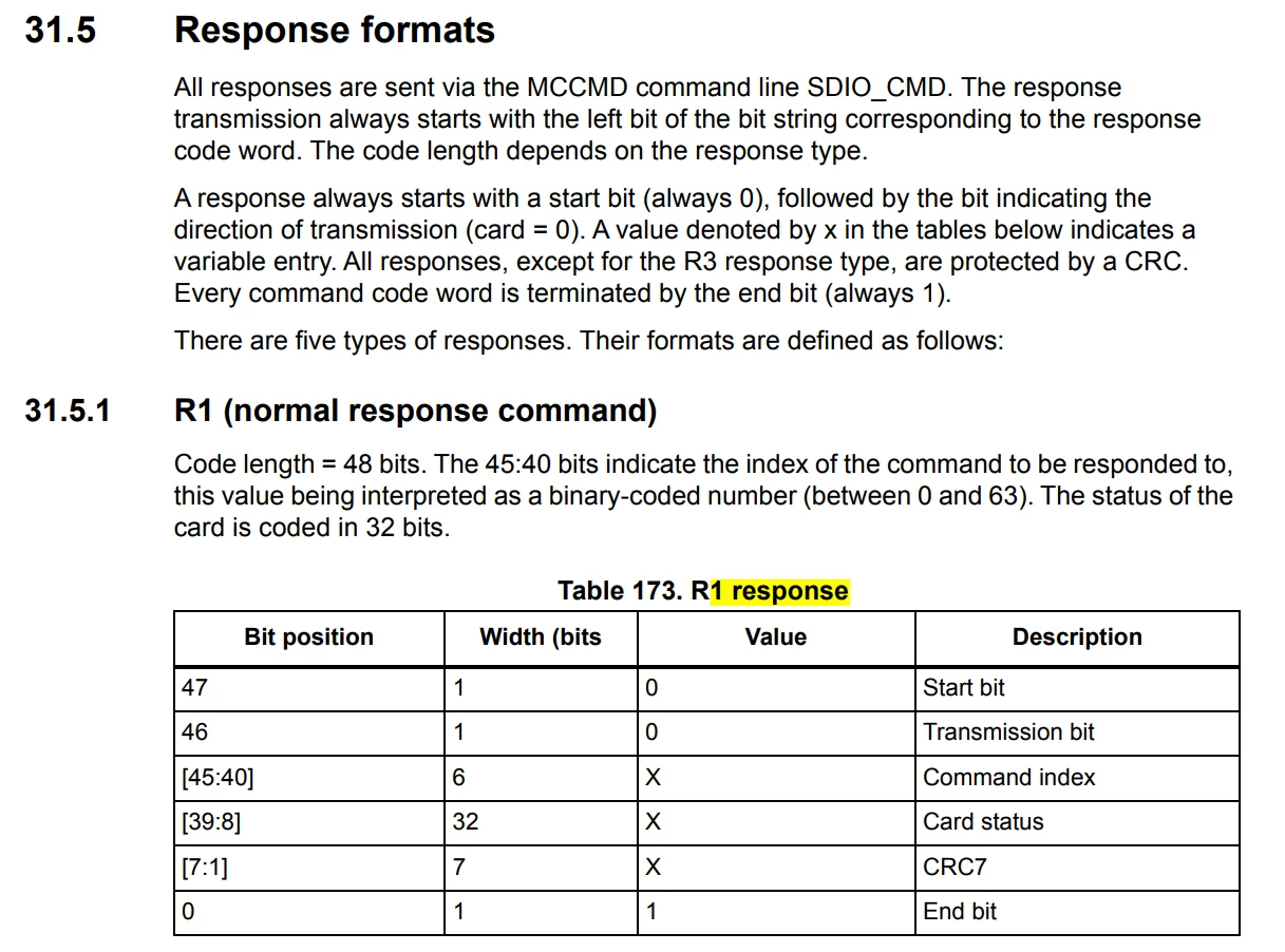

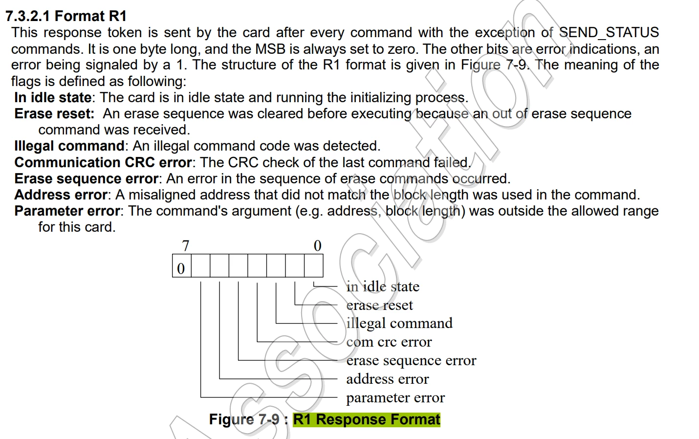

Do SD mode and SPI mode have different response formats for R1?
I figured out that R1 response format is different in the STM32 specification as the below
But in the Physical Layer Simplified Specification, there is a definition of R1 Format.
_legacyfs_online_stmicro_images_0693W00000bhehUQAQ.png​
Actually I expect that R1's response format is supposed to be the same in everywhere.
But they appear different format in different specification.
Can I get some explanation for this to understand?
