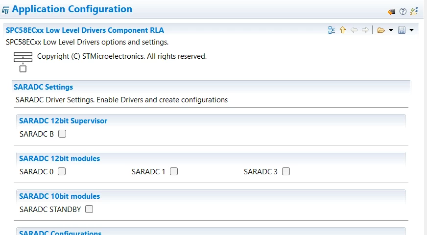

Hi everyone,
I’m working on configuring the SARADC in the SPC58ECxx using the RLA (Low-Level Drivers) tool. I want to read an analog signal on PE0 / ADC-AN11.
In the SARADC settings, I see the following options:
  • SARADC B
  • SARADC 0
  • SARADC 1
  • SARADC 3
  • SARADC 10bit modules
  • SARADC STANDBY
I’m a bit confused about which options I actually need to select. I understand that SARADC0 is the module connected to my pin, but I’m not entirely clear on the purpose of SARADC B and the other options.
Could someone clarify:
  1. What each of these options actually does.
  2. Which options I need to select if I only want to read PE0 / AN11 with SARADC0.
2 replies
November 17, 2025
For reading PE0 / ADC-AN11, you only need to enable SARADC0 and the 10-bit resolution module. SARADC B and STANDBY options are for internal calibration and low-power modes, so they aren’t required for a basic single-channel read. Make sure your channel mapping in the RLA matches AN11 to SARADC0.
Giuseppe DI-GIORE
December 17, 2025
SARADC_B is the Supervisor SARADC able to read all analog channels. It is mainly used by safety task (redundancy).
Typical usage is:
  1. select a channel, read it SARADC_[0,1,2, ...]
  2. at the same time read the same channel using SARADC_B
  3. compare the two values
