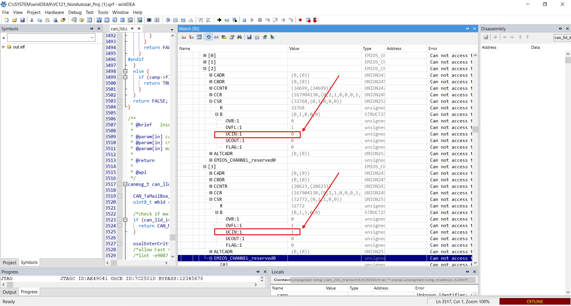

Hi Team,
we are using SPC56EC70B3 Microcontroller, We are trying to give a digital signal to the corresponding pins PA[1], PA[2], PC[8], and PC[9]. All the pins are configured in the same way on the software side, we have also enabled the diagnostics pins for the above corresponding pins; we can't able capture any frequency from the pin PC [8]. Rest all the pins are working as expected. Then We identified a discrepancy in the malfunctioning pin PC[8] within the UCIN of the CSR in the eMIOS UC Status Register. Specifically, for channel 3, it consistently remains in a high state (1). This issue is critical to our project, and we urgently request your assistance in resolving it.
