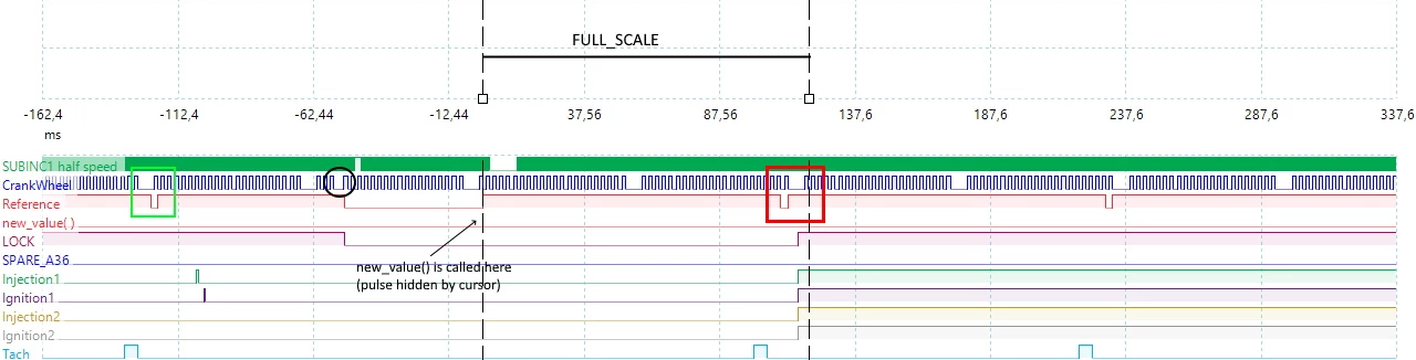

I am struggling to understand why the provided example seem not to behave as expected:
  • upon startup, when the gap is detected, the generated Reference_position (TDC) turns out to be localized 1 tooth AFTER the calculated one (angular ticks math), even if the values written to the TBU_CHANNEL1 register are correct. It looks like the match-value is only loaded into the CCU register of the ATOM channel only 1 active edge AFTER (This could be overcome with a one-time only -cold boot- compensation btw).
  • but it's not over: after a lock-loss scenario (take 1 tooth off the crankwheel, e.g.) the resynchronization procedure is carrried out following the same steps as on startup but this time (oddly enough) the Reference_position (TDC) ends up 3 teeth (angular position) BEFORE where it is expected. There must be something with the CPU loading the CCU register values for next matching...

    Ok, it looks like I'm the only one who struggled with this. So here is my solution (which came after quite some non-painless testing):
    • to prevent the 1 tooth DELAY on the programmed reference position after the gap is first detected, make sure you subtract to the offset value you are displacing the position to an amount equivalent to 1 tooth in microticks (TOOH_MULTIPLIER). This wil displace your 'future' reference position in a coherent manner with the angular events you may schedule at the moment you are detcting the gap. Successive reference position updates, instead, can be displaced of exactly of one or two complete crankwheel cycles directly when the reference_position isr handler is executed.
    • in the missing_tooth-lockloss-relock scenario, in orde to make sure the microticks count stops without messing up your reference, you will want to disable DPLL subinc1 generation right at the lock-loss isr handling by calling gtm_dpllDisableSubInc1(). This ensures that no microticks are generated until they are needed: when the gap will be detected again (followed by DPLL re-sync, etc.)
    Hopefully this can be of use if you are confused about what is going on in the process.

    There is no direct function but you can leverage on the clock signal routings internal to the GTM.
    You can expose the subinc1 pulses to a TOM channel output, at a half of the real freqeuncy:
    • configure the CMU of the GTM so that CMU_FXCLK0 is fed by [CMU_CLK7 / (2^0)] and make sure you set CMU_CLK7.SEL = 1. This last setting will route the subinc1 pulses from the DPLL to CMU_CLK7 output
    • Then pick a TOM channel (e.g. TOM1[4]), choose CMU_FXCLK0 as it clock source and enter 2 for Period and 1 for Duty-cycle
    • configure the SIUL2 to route the TOM output to the output pin you choose
    the TOM channel output will 'track' subinc1 pulses at half of its speed. I use this to investigate when the DPLL actually starts/stops generating subinc1 pulses in response to setting changes
