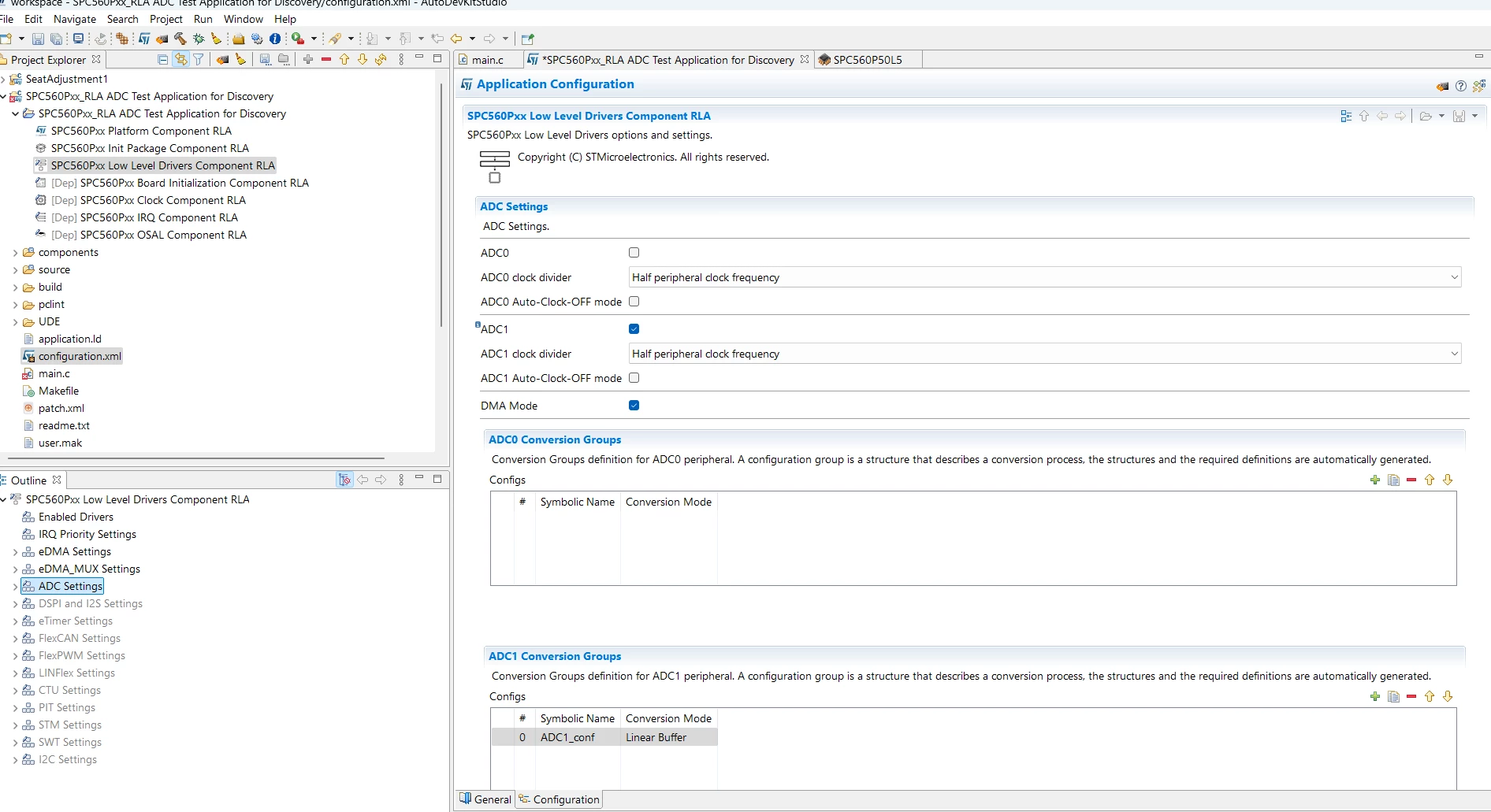

I want to suggest how to configure the ADC and read its value using AutoDevKit.
You can use your library if you want, but you must pass the ADC value to it correctly.
Alternatively, without using your library, you can read the raw ADC value and convert it to degrees Celsius (°C) using the NTC values and parameters.
hope this can help and clarify.

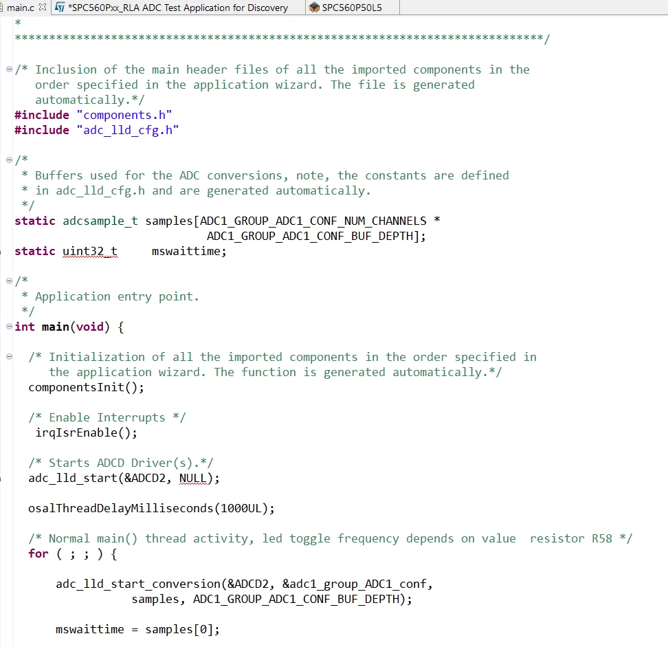

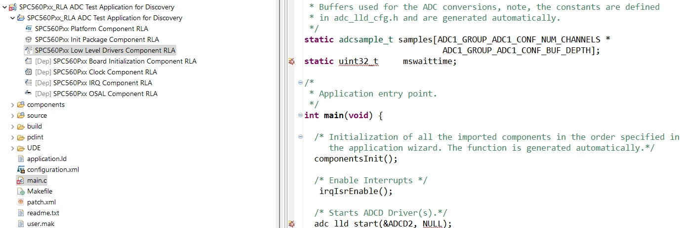

To solve the problem you highlighted, please import the demo "SPC56xx_RLA ADC Test Application for Discovery".
It shows how to use the ADC with the SPC56 microcontroller. You can compare your ADC configuration with the one in the demo
and refer to the main.c file to see how to read data from the ADC.
