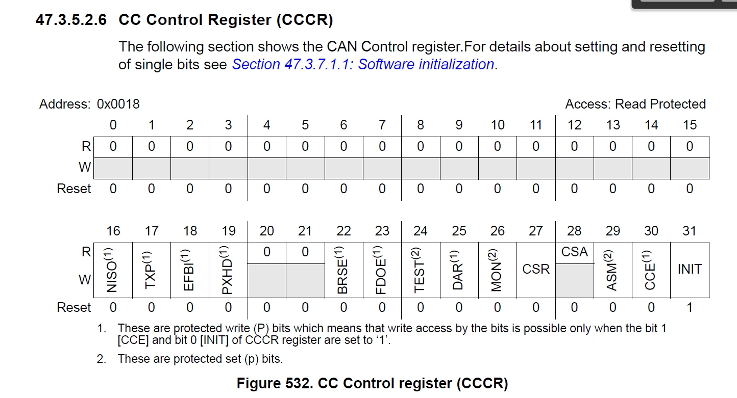

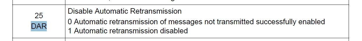

In the CCCR control register, the "DAR" bit is in charge of handling the enabling/disabling of automatic retransmission. This bit is set to 0 for default which means that automatic retransmission of unsuccessfully transmitted messages is enabled. (See the Reference Manual RM 0407 of the SPC58 C Line paragraph 47.3.5.2.6 CC Control Register (CCCR))

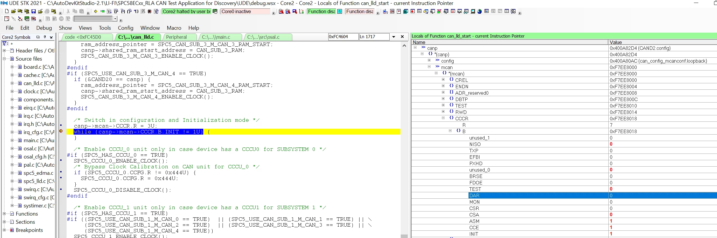

Finally, the following image shows that by default, low-level CAN drivers configure the DAR register to 0.

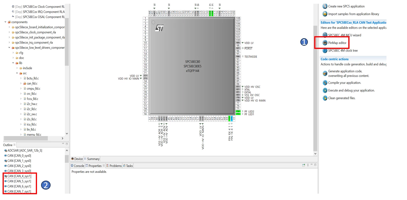

  Now, to know which CAN driver belongs to a subsystem, you have to:
  - select the Pin Map editor
  - The outline Tab shows all CANs, and the label highlights the subsystem it belongs to. See image below.
In the image above, CAN 4 Sys 1 was selected by selecting pins 70 and 71.
 This choice, after the code generation, enables the CAN7 pointer in the can_lld.c. file to be used in the can_lld_start(....) command.
