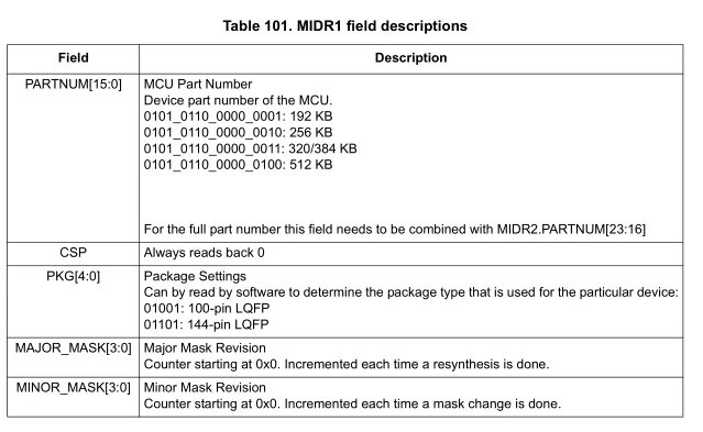

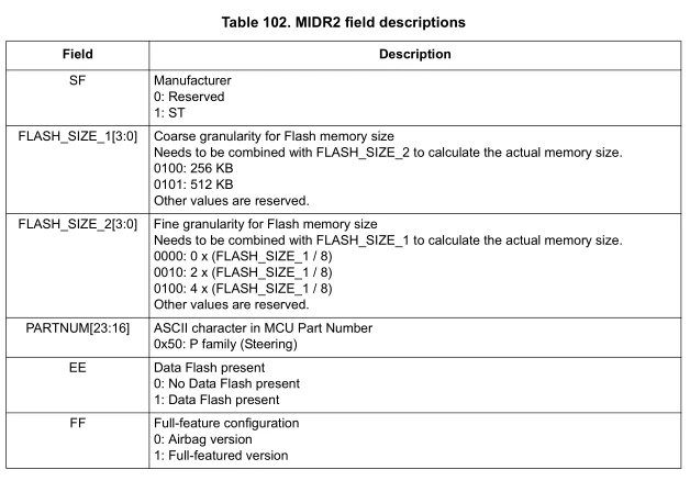

SPC560P50L3 MCU ID
The chip I am currently using is SPC560P50L3, I need a unique MCU ID for calculation, but I checked the MCU ID registers of the two chips and found that the information is the same, MIDR1=0x56042416, MIDR2=0xA8005011. is this normal?Or if there is any other unique ID for this chip, please let me know, Thanks.
