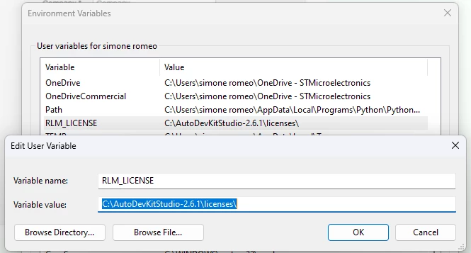

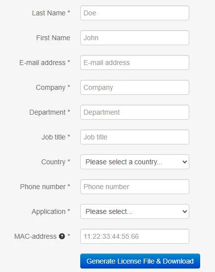

Hi there,
if the error you are facing is related to your "Free Hightec license" then:
1) go to https://register.hightec-rt.com/st/spc5x/
2) open command prompt
3) type:  ipconfig/all
4) find your MAC address
5) fill the following prompt with the correct informations and generate:
6) Copy the generated license in:   C:\AutoDevKitStudio-2.6.1\licenses
to verify, check RLM_LICENSE from your environmental variables.
Otherwise, you can use ppc-freevle-gcc for your application, you do not need the license hightec to run AutoDevKit or flash your boards.
Best Regards,
Simone
AEK Team
