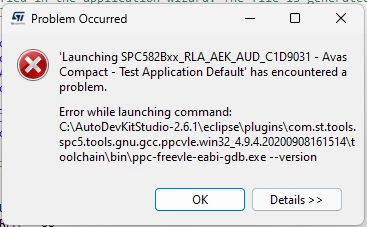

I installed newer version of AutoDevKit studio from ST website and imported a project fromm samples.
I tried to flash the generated elf but it is giving following error.

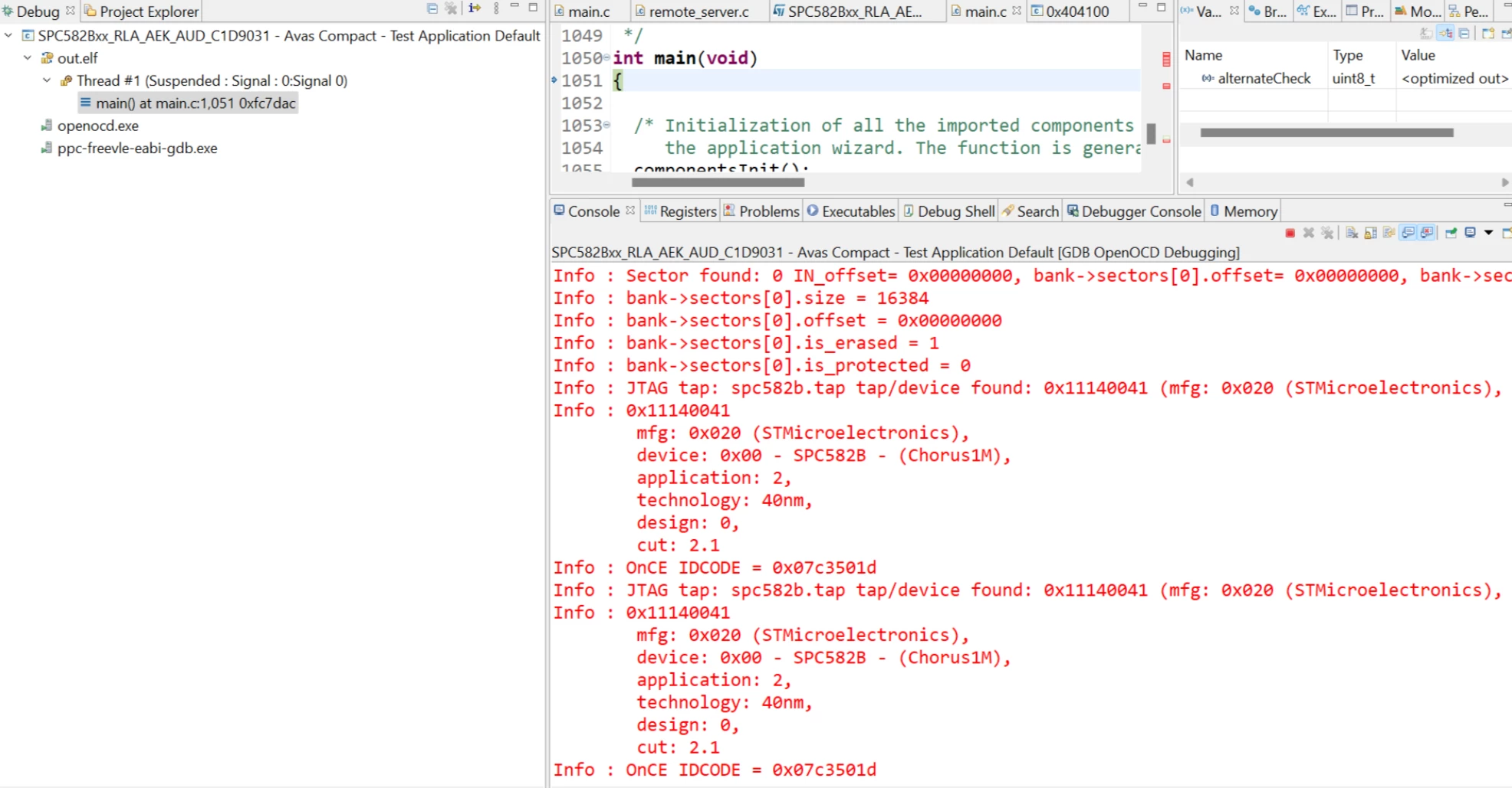

Jun 25, 2025 8:03 AM UTC
Hello Mohit,
I just imported the same demo you mentioned in the post using AutoDevKit 2.6.1.
I cleaned and compiled the project. At this point, I flashed the generated Elf file into the board using OpenOCD without any problems. (see image below)
I suggest removing the project from the Project Explorer, re-importing it from scratch, cleaning and recompiling it, and then flashing the compiled code using OpenOCD.

Jun 25, 2025 8:28 AM UTC
I tried again as per your steps, still it is not flashing.
having same error.
What I understood is if I install Autodevkit studio, then it will install all supporting files.
Additionally, I installed SPC5LNK driver as per instructions on ST site
