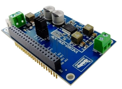

Is the board important for the AVAS project?
Hi, i have a AEK-AUD-D903V1 evaluation board and i want to make a simple AVAS project. I don't have any board with SPC582Bx microcontroller board. Can I implement this application to stm32 board ? if i can, how should i progress ?

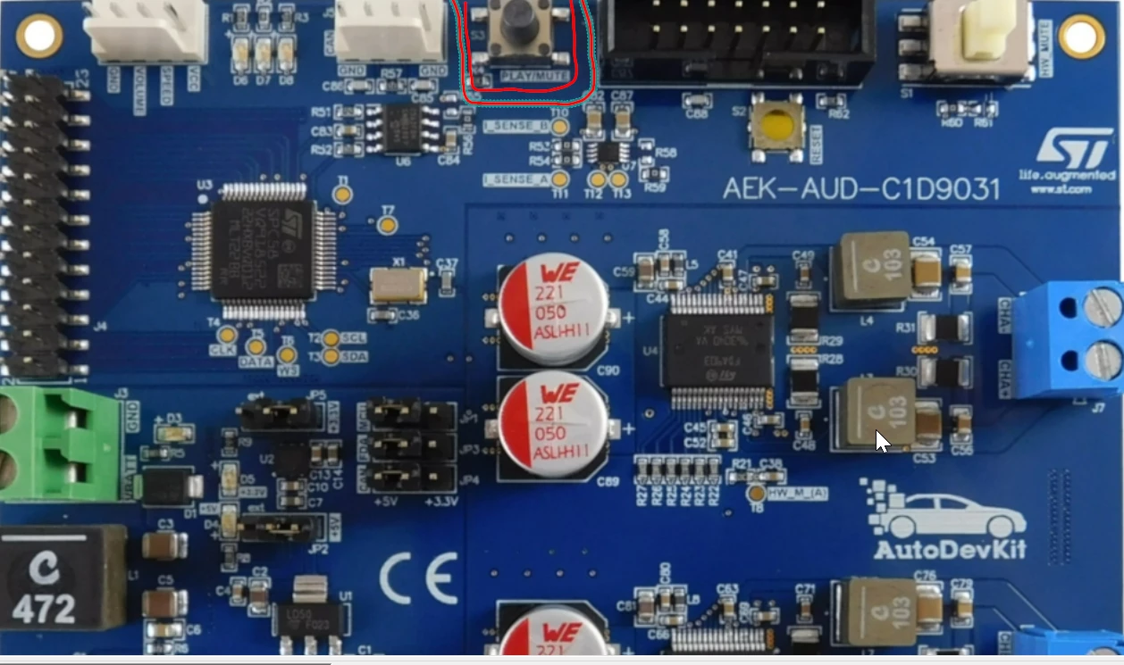

    What do you mean by play/mute buttons? There is no button on the AEK-AUD-D903V1 ​​board.

    This button:

    If you want to work with other microcontrollers including STM32, you need to use AEK-AUD-D9031 containing only the FDA903D audio amplifier with the MCU discovery but you need to build the entire code stack by yourself because we do not support it.

    The board I mentioned was already the model containing only FDA903D.
    I thought it would be enough to configure the AEK-AUD-D903V1.c driver for STM32. Could you tell me what else I need to change?
