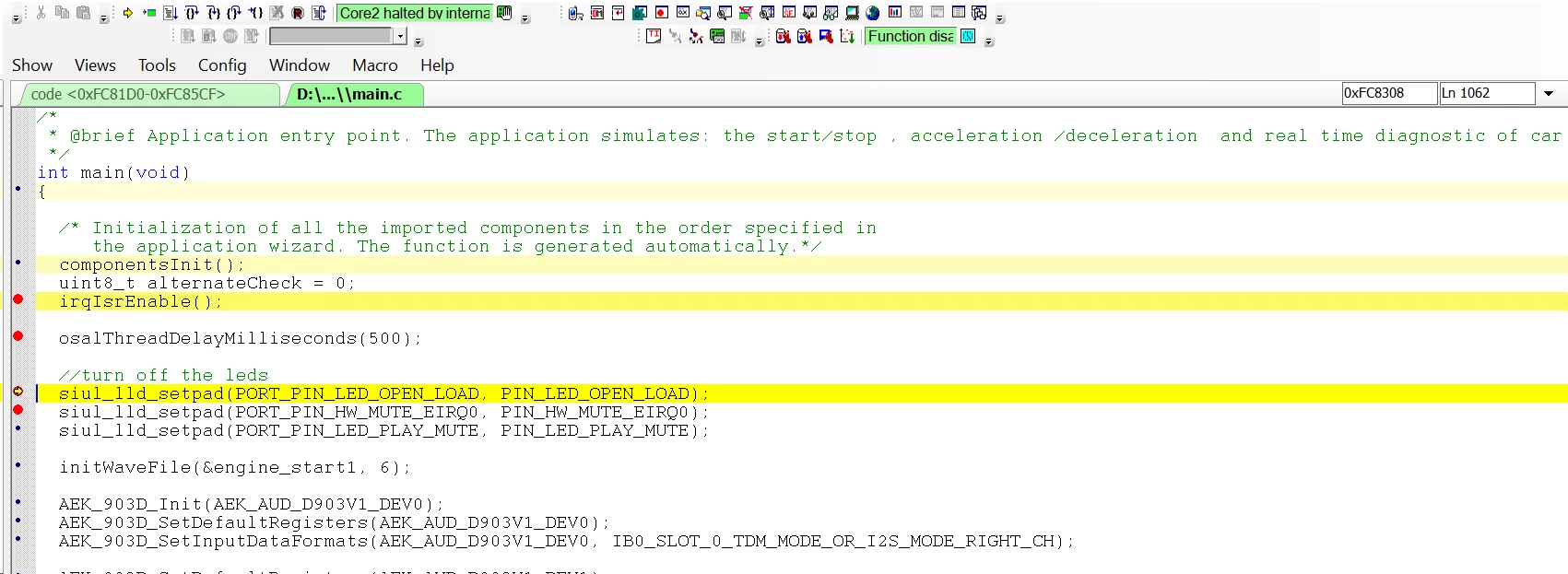

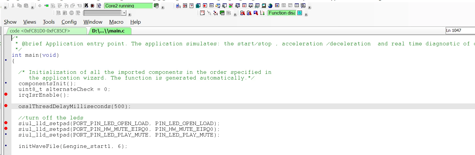

I'm currently working with the AEK-AUD-C1D9031 development board and utilizing the "AVAS Compact 2.0 - Test Application" example code from AutoDevKitStudio2.2.1. I'm seeking assistance in extending this example code with FreeRTOS. However, upon including FreeRTOS_RLA, I'm encountering issues with CAN communication. During debugging, I noticed that the flow gets stuck at osalThreadDelayMilliseconds(500). Could anyone offer guidance on resolving this issue? Any help would be greatly appreciated. Thank you.

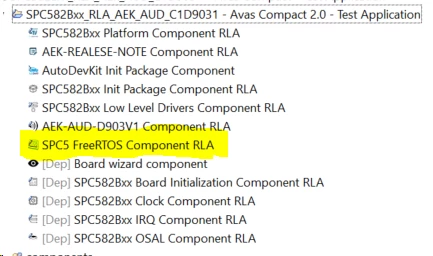

Here integrated the freeRTOS into project.

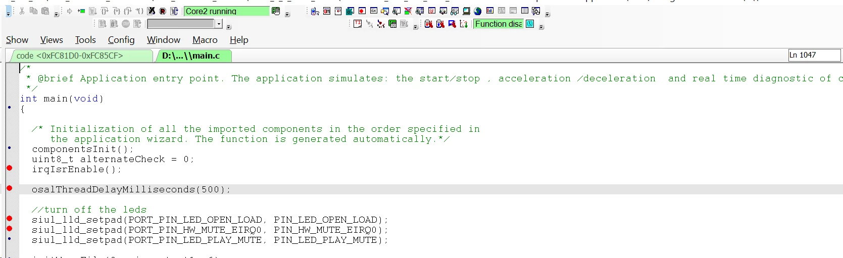

Added Break point.

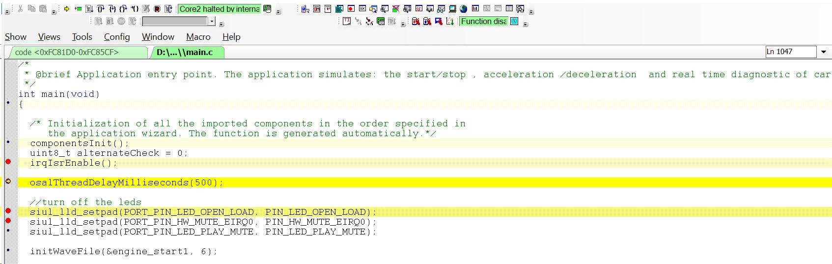

4 break points added
It is hitting 1,3,2 break points
it is hitting osalThreadDelayMilliseconds(500);(2 break point)
heat the program is stopped.

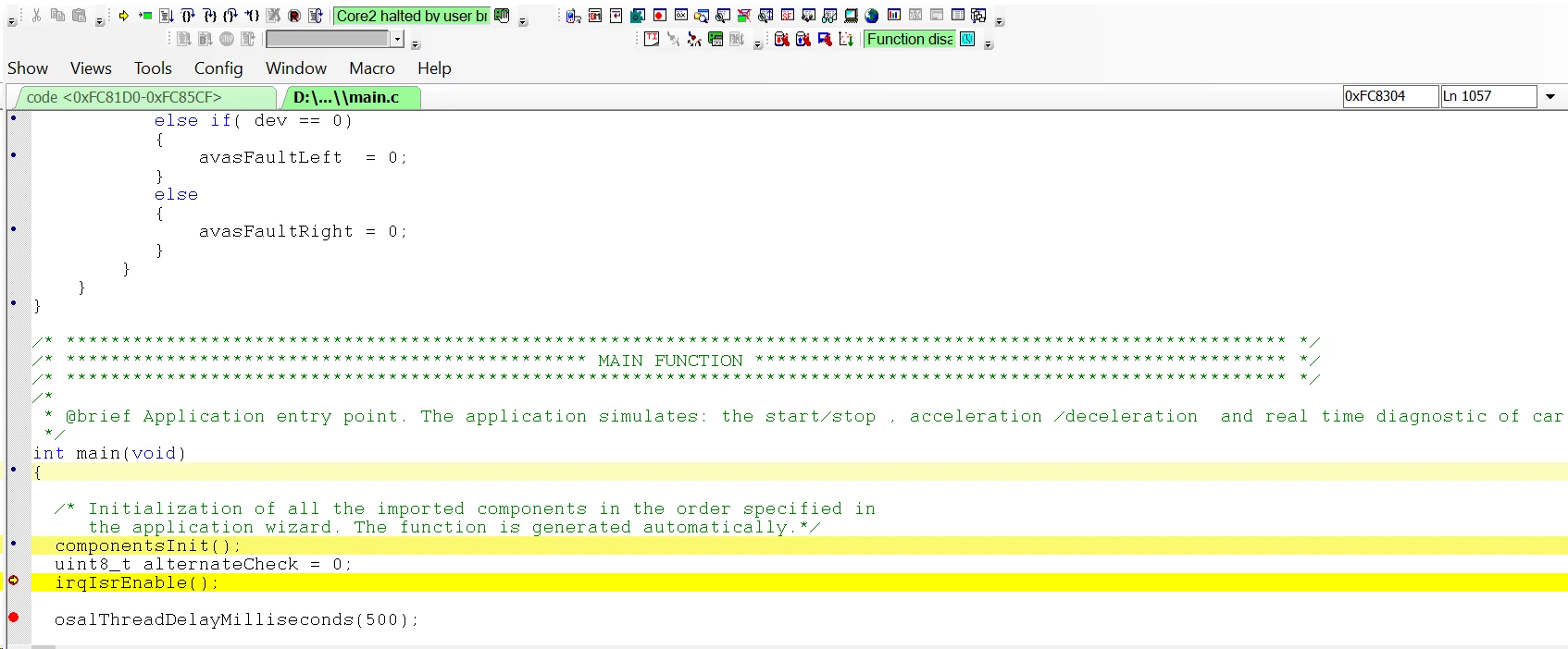

Hello Shiva ,
You are limited to the number of breakpoints with PLS
i recommend to switch in assembler mode and reduce the number of breakpoints.
if you want to use FreeRTOS you should have a main.c like that :
SPC582Bxx_RLA FreeRTOS SERIAL Test Application for Discovery (cf example)
FreeRTOS is using the tick too
