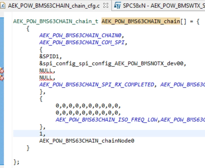

How properly connect multiple L9963E in daisy chain
how to properly connect multiple L9963E in daisy chain? already tried many mode and tweak. follow the design in datasheet, for transformer isolated and capacitive, but still unable to init. for the first chip, I use SPI. init the first chip is correct, but for the upper L9963E always failed. the mcu I use SPC582B
signal seems good, but the ISO transceiver of the chip unable to read.
maybe there any member here thats already succesfully connect the daisy chain ISO

Yes I already follow all those evaluation design, AEK-POW-BMSNOTXfor the L9963E base ( connect to MCU), and the upper L9963E using AEK-POW-BMS63EN. but still failed to initialize the upper L9963E. the signal in ISOHp/m and ISOLp/m is good, amplitude around 150mV but still the upper chip unable to receive. I already tried the Capacitive Isolation, its same, no working.
just, seldomly the init succed, after succed the data reading for the upper L9963E is okay. but once I power-off the chip, its will really difficult to connect again.

If your custom build is electrically equal to AEK-POW-BMSNOTX + AEK-POW-BMS63EN daisy chain configuration, then what may be wrong is the software.
I suggest you check the following AutodevKit demo project:
 SPC582B - AEK_POW_BMSNOTX_SOC_Est_SingleAccess_CHAIN application for discovery
What should change from the demo application (apart from pin allocation) is just the following data field:
AEK_POW_BMS63CHAIN_node_num =  2
Please note that when a modification on a config file is done, you need to "save" and then "build" by using the Hammer icon (or else the code rerolls back to the default configuration)
Make sure your HW configuration is consistent with the suggested.
