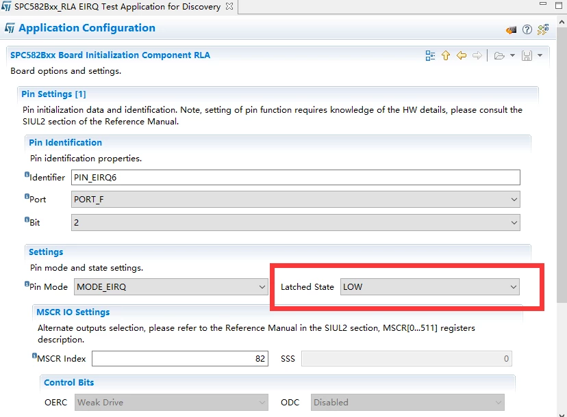

Hello! I want to ask a question about setting up EIRQ!
Hello! I would like to ask what is the meaning of setting the Latched state option in the red box as shown in the following figure? I didn't see any specific definition or explanation related to this in the SPC58 reference manual? Can you tell me where to view its related content? Thank you.QQ图片20240603110635.png

Hi Bwang,
In AutoDevKit Studio the pins are set to latched state Low by default, because a low signal can be used to save energy.
Of course, the pin configuration can be changed according to the needs of your application.
Thanks,
AutoDevKit Team
