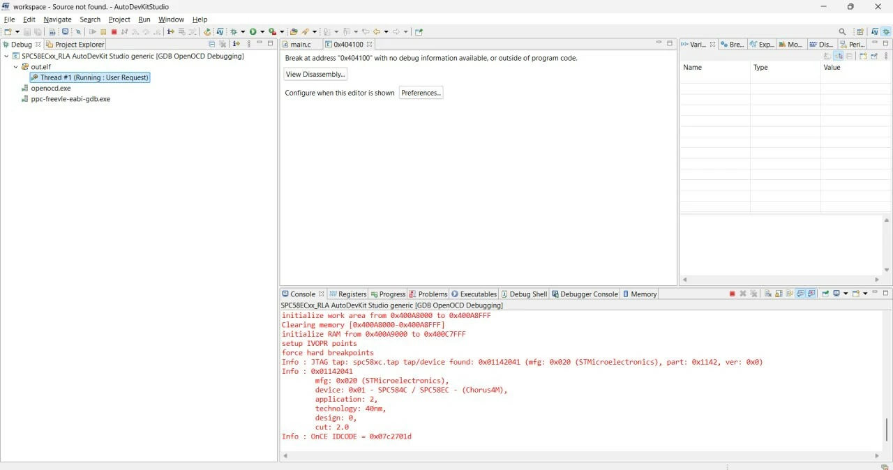

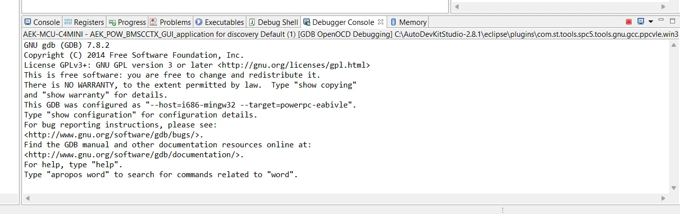

When I launch a debug session, OpenOCD connects successfully, halts the target, and identifies the chip. However, the execution is stuck with the following error: Break at address “0x404100 with no debug information available, or outside of program code.
I am fully aware that the "Source not found" window shown by the IDE is simply a consequence of the core hanging at this specific exception handler address (which naturally lacks source code), rather than a misconfigured source path.
The main anomaly I noticed is a Flash Loading Failure accompanied by GDB packet warnings. In the OpenOCD console, right after reading the flash banks, I get the following warnings: Warn : negative reply, retrying Warn : acknowledgment received, but no packet pending Consequently, the Debugger Console (GDB) only shows the initial GNU GDB welcome message. It appears that due to this communication protocol drop, AutoDevKit is not actually sending/loading the .elf file into the flash memory, despite the debugger connecting properly.

5. Expected behavior
The IDE should load the newly compiled .elf firmware into the microcontroller's flash memory, and the debugger should halt correctly at the main() function, allowing me to step through the code.
6. How to reproduce
  1. Connect the AEK-MCU-C4MINI1 to the PC using the AEK-MCU-SPC5LNK debugger.
  2. Create or import a standard SPC5 Application Component project in AutoDevKit Studio.
  3. Build the project.
  4. Launch the GDB OpenOCD Debugging configuration.
  5. The debug session starts but hangs immediately at 0x404100.

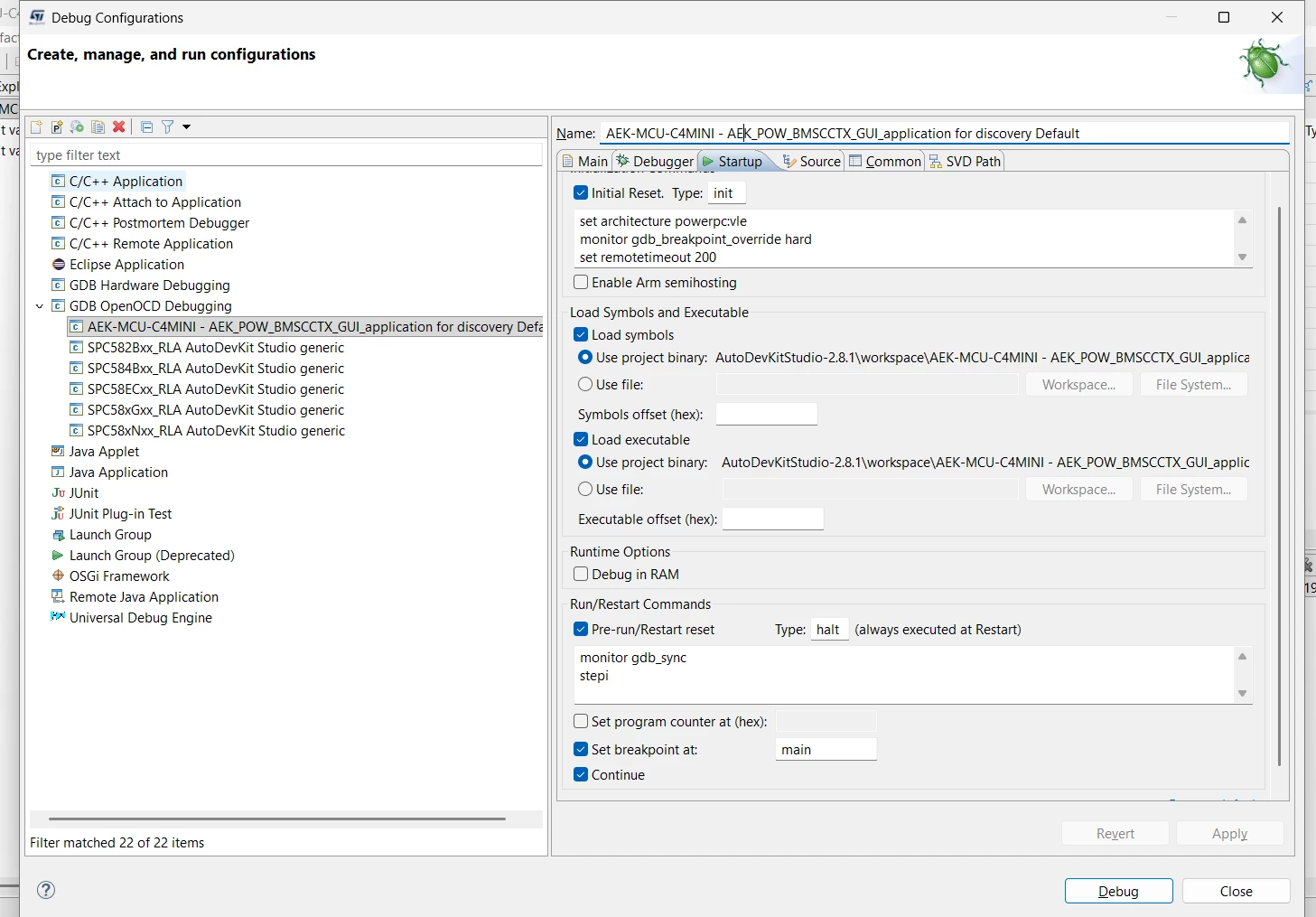

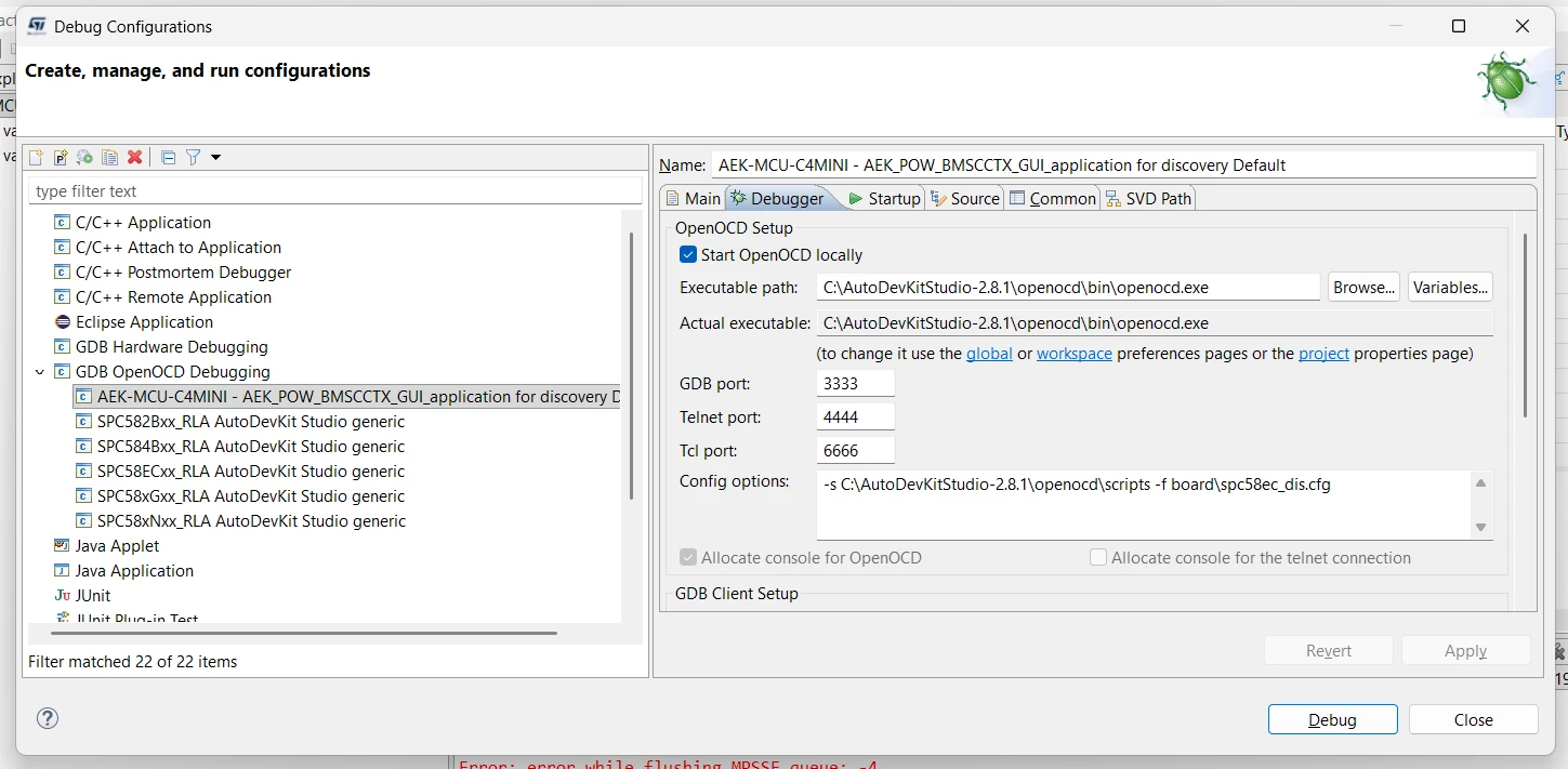

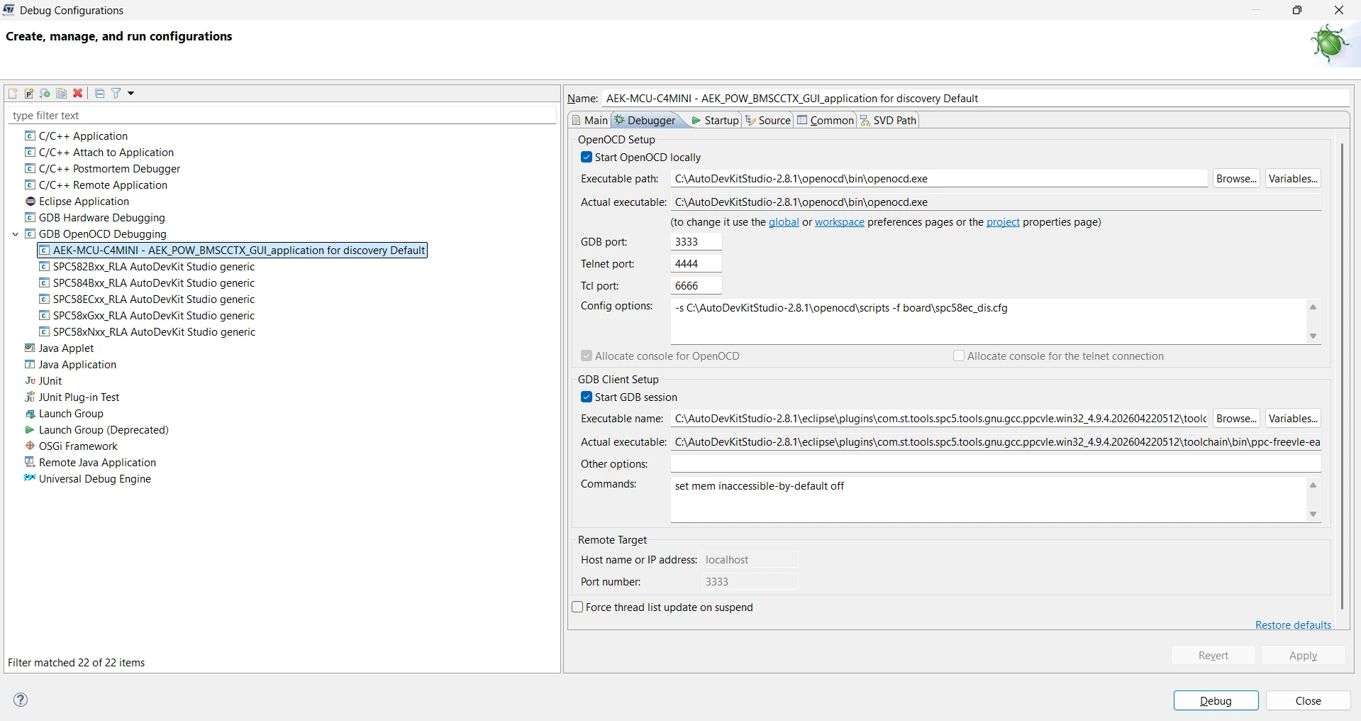

Debug configuration:
SVD path: C:\AutoDevKitStudio-2.8.1\openocd\svd\spc58\SPC58ECx.svd
7. Occurrence Systematic (happens 100% of the time).
8. Sanity checks

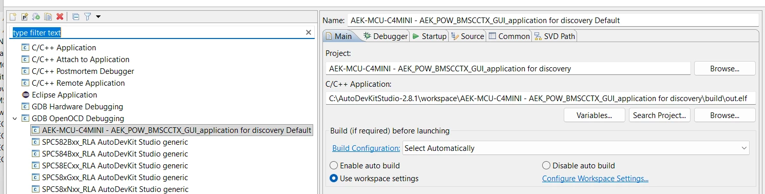

I have already performed the following troubleshooting steps to rule out basic configuration errors:
  • Executable Linked: Confirmed that the correct out.elf file is explicitly selected in the Debug Configuration -> Main tab.
  • Startup Configuration: Confirmed that Load excecutable and Load symbols are checked in the Startup tab.
  • Target Config: Ensured the OpenOCD config points to board\spc58ec_dis.cfg to match the detected IDCODE.

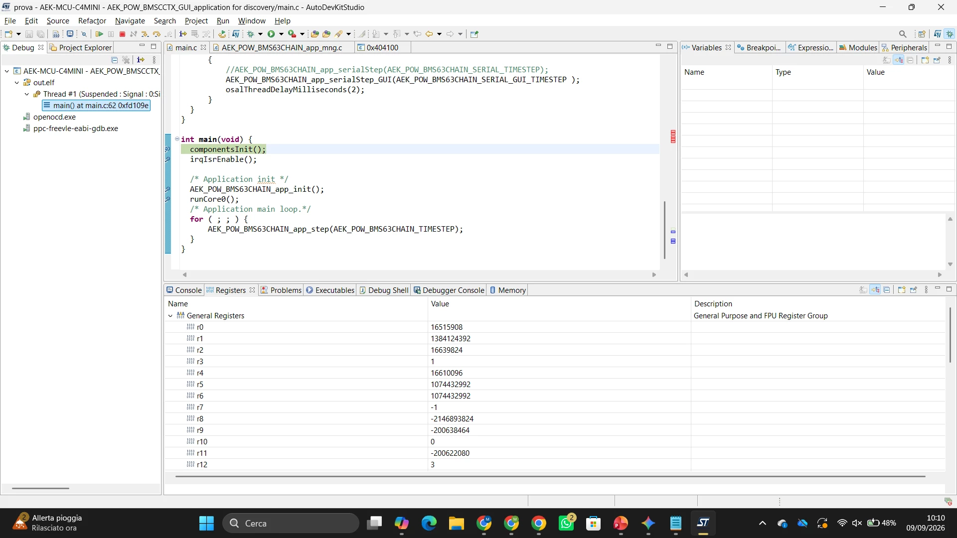

Great news: I finally managed to debug the board!
I decided to start over and import the project from scratch one more time, and now everything works flawlessly. There was probably some corrupted file or weird configuration error in the previous project, but the important thing is that it is fully working now!
Thanks again for your time and support!

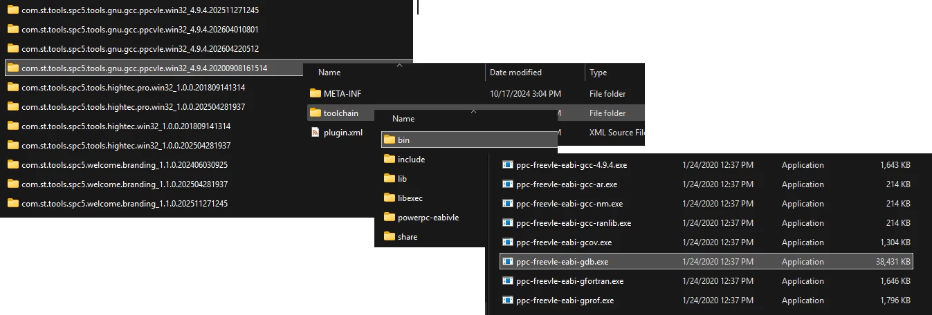

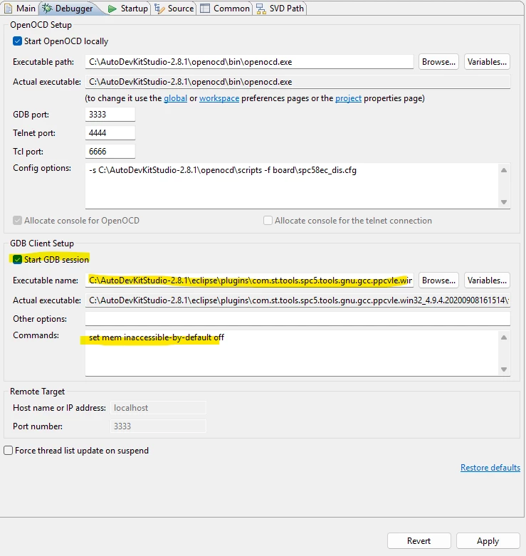

But it seems the second half of the “Debugger” section has been forgotten. Check if also that part is correct:
You should point to the following executable:
C:\AutoDevKitStudio-2.8.1\eclipse\plugins\com.st.tools.spc5.tools.gnu.gcc.ppcvle.win32_4.9.4.20200908161514\toolchain\bin\ppc-freevle-eabi-gdb.exe
Please Note that AutoDevKit is for Windows only. We cannot guarantee support on MAC “Emulated Windows environments”.
In case either this doesn’t solve your issue, then the problem may be a damaged USB cable, or, your USB port rights.

1. Debugger Configuration I checked my configuration and it seems to match your instructions. The only difference is the plugin timestamp in the folder name (my AutoDevKit installation has a more recent version: 20264220512 instead of 20200908161514), but it correctly points to the ppc-freevle-eabi-gdb.exe file. I also kept the set mem inaccessible-by-default off command as you suggested.
2. Environment & Hardware Checks
Just to give you more context, I am running natively on Windows 11 (no MAC/emulated environments). Furthermore, the Windows Device Manager correctly identifies all the ST evaluation board interfaces without any warning triangles.
To check if the hardware was okay, I tried communicating with the board directly using AutoDevKit's External Tools (OpenOCD). The board responded perfectly to the connection without any drops. Because of this, I would probably exclude a damaged USB cable or USB port rights issues.

SRomeo
Aug 20, 2026 3:01 PM UTC
I also have a 2026 installation.

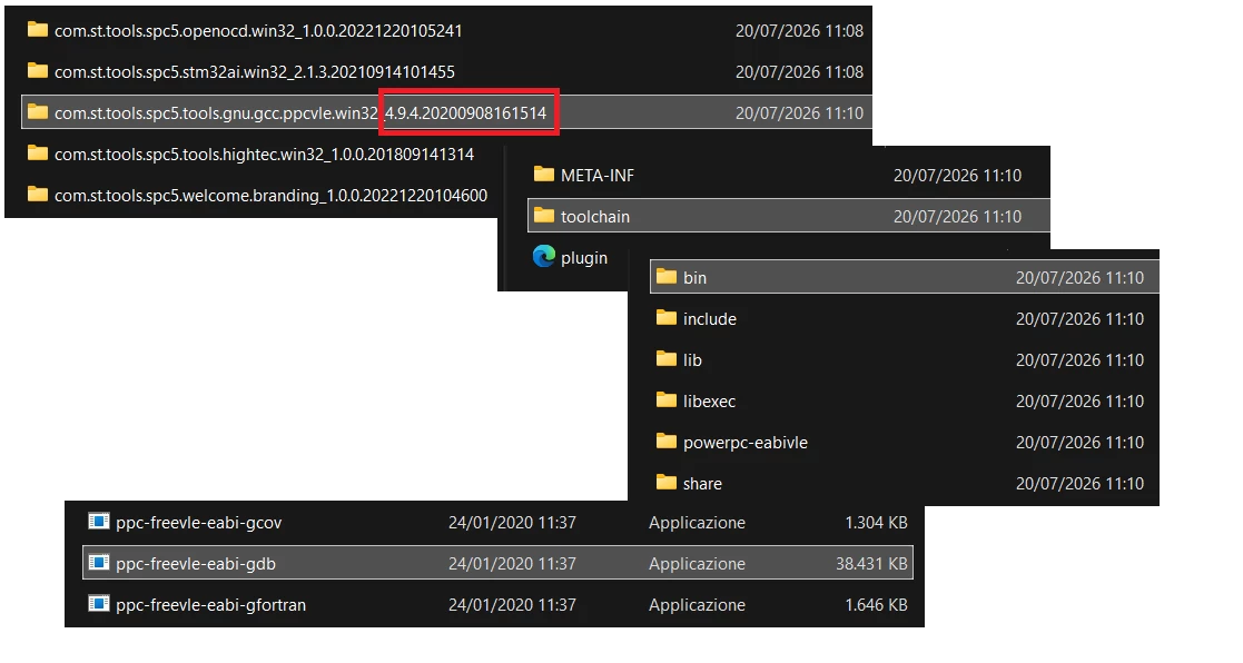

But the “com.st.tool.spc5.tools.gnu.gcc.ppcvle.win32” folder to use is the following:
give it a try
Simone

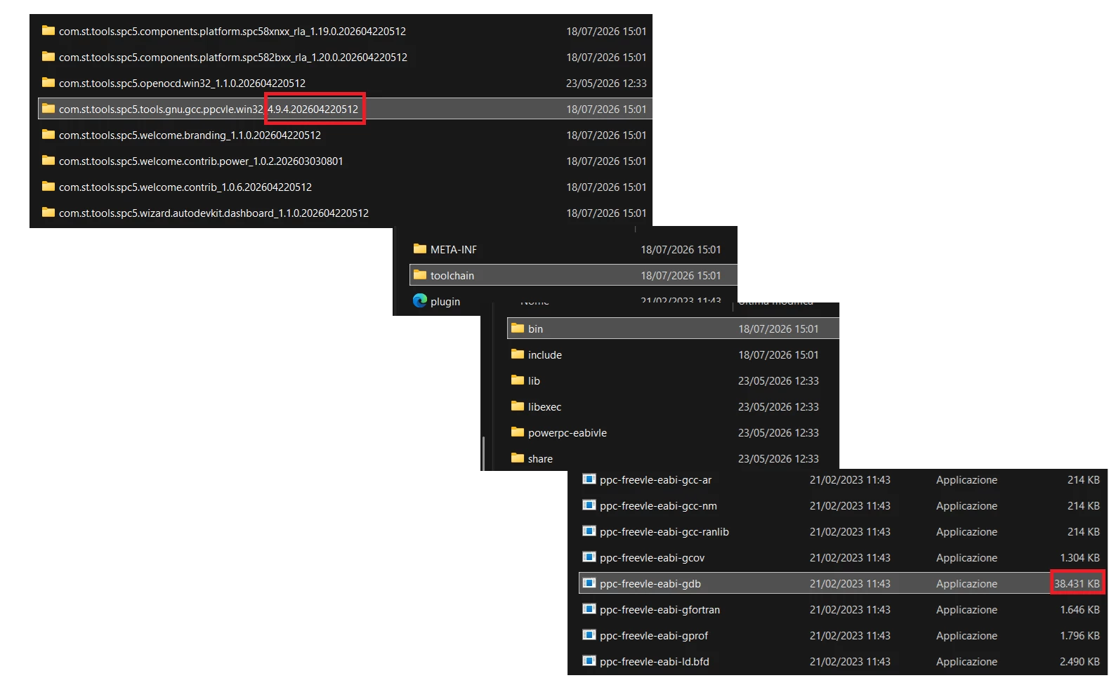

Aug 20, 2026 4:44 PM UTC
Hi Simone,
I checked my plugins directory, but I do not have the 20200908161514 folder. Since I did a fresh installation of the program recently, my environment only contains the 202604220512 folder. However, I noticed from your screenshot that the only real difference is just the folder name: the rest of the path, the executable name (ppc-freevle-eabi-gdb.exe), and its exact size in KB are completely identical (38431 KB).
My deduction is that they are actually the exact same file. I might be wrong, but I guess it should still work correctly regardless of the folder version. Nevertheless, even with this setup, I keep getting the exact same 0x404100 error.
C:\AutoDevKitStudio-2.8.1\eclipse\plugins\com.st.tools.spc5.tools.gnu.gcc.ppcvle.win32_4.9.4.202604220512\toolchain\bin

  8. After a while, check if main is visible and the code debuggable.

Hi Simone,
