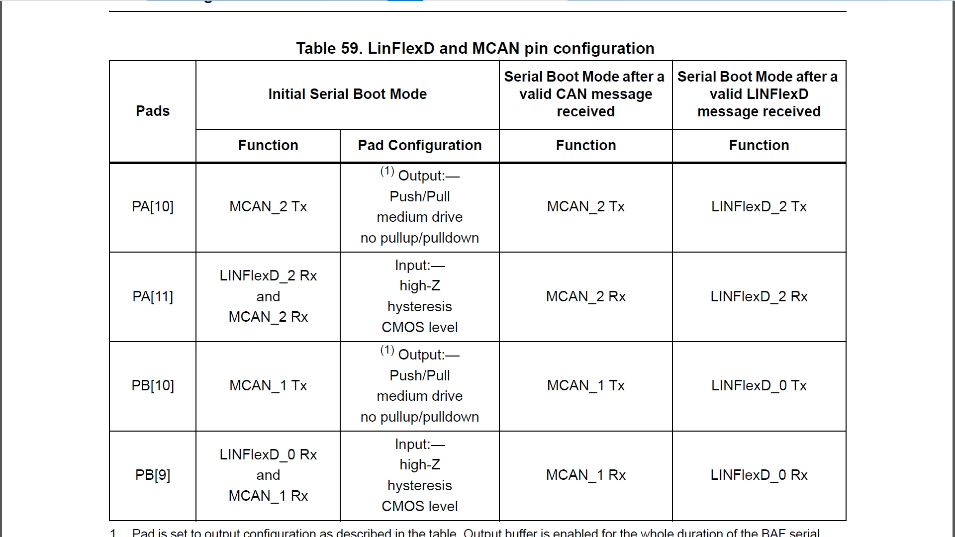

BAF concept , transmitting .elf file through CAN
Im using SPC58C80E5, working on Autodevkit studio,

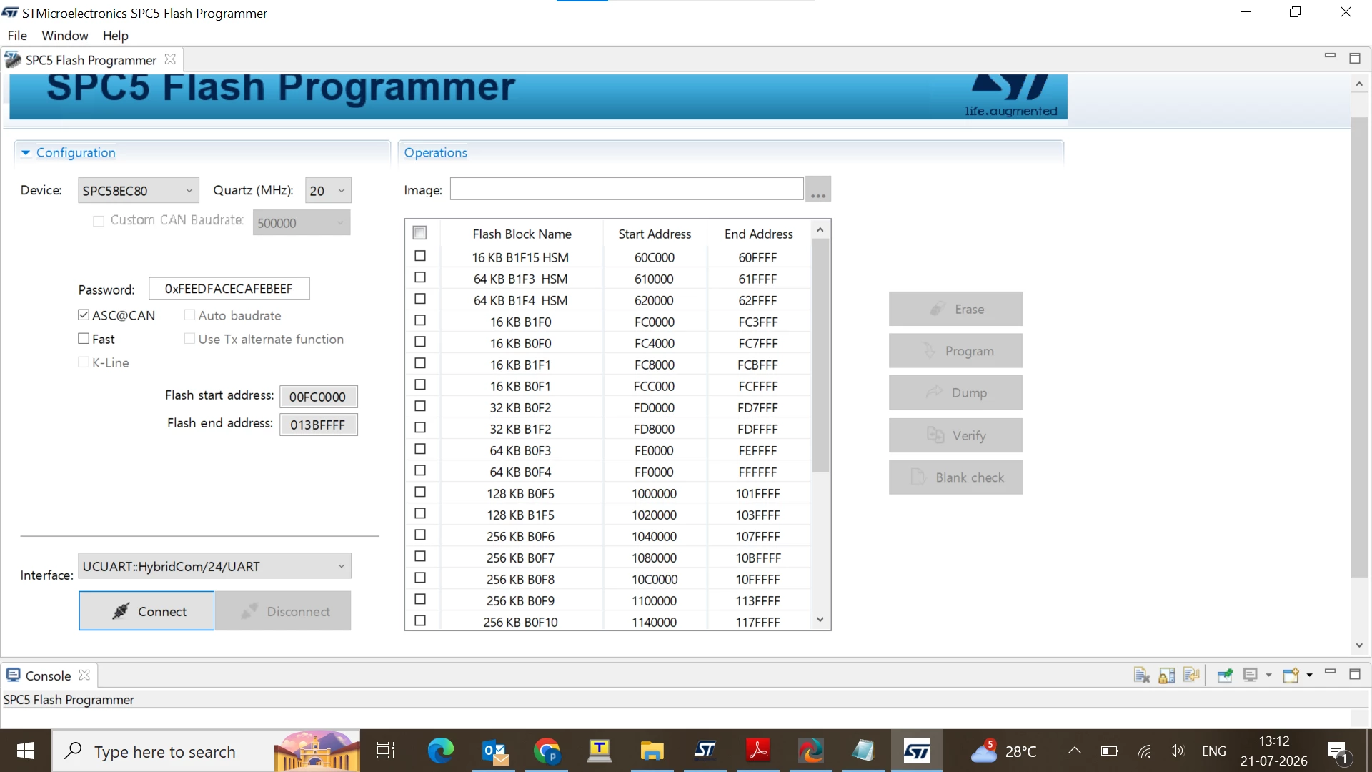

first im executing this code LED is blinking after that when i send CAN message with ID 7F0 and data AA the LEDs becoming freeze if im resetting also they are in freeze, after that using SPC5 Flash programmer trying to flash the file but when i select the interface and click connect its loading not connecting, and also the port is not used by any other applications .
Im using ICP CON i-7530 as intermediate between PC and microcontroller to communicate with CAN . IN CAN im using PB[9] and PB[10] according to the SPC58EC user manual , check wt is happening please help with it.

I am seeking assistance with troubleshooting a software reset issue on the SPC58C80E5. When triggering a reset via CAN ID 0x7F0, the MCU enters a freeze state rather than rebooting, which prevents the SPC5 Flash Programmer from connecting over JTAG/SWD. I would like guidance on the correct register key sequence for triggering an MC_RGM/MC_ME reset or the recommended HAL API function to use in AutoDevKit Studio.
Pooja1Author
Jul 27, 2026 5:32 AM UTC
In fields i’m not allowed to use JTAG so that using CAN i wanted to dump my .elf file through CAN using SPC5 flash programmer to the SPC58EC80E5 controller please help me wt to do.
