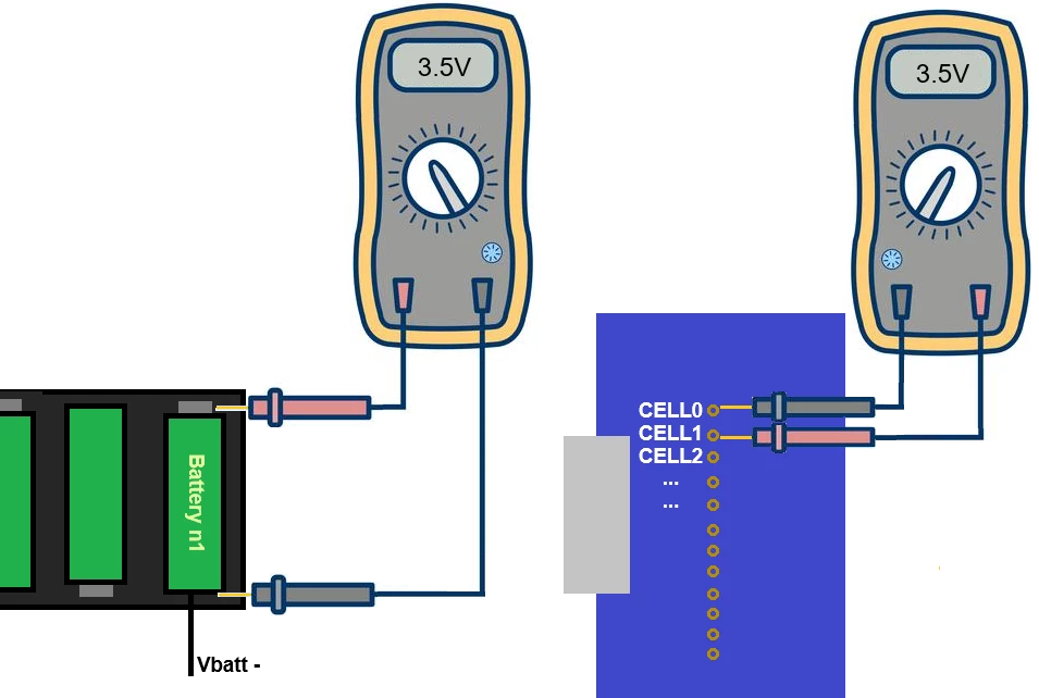

To check if the measurement are right I suggest to compare voltages as in the picture:
If you have any doubts please take a look to the schematic.
