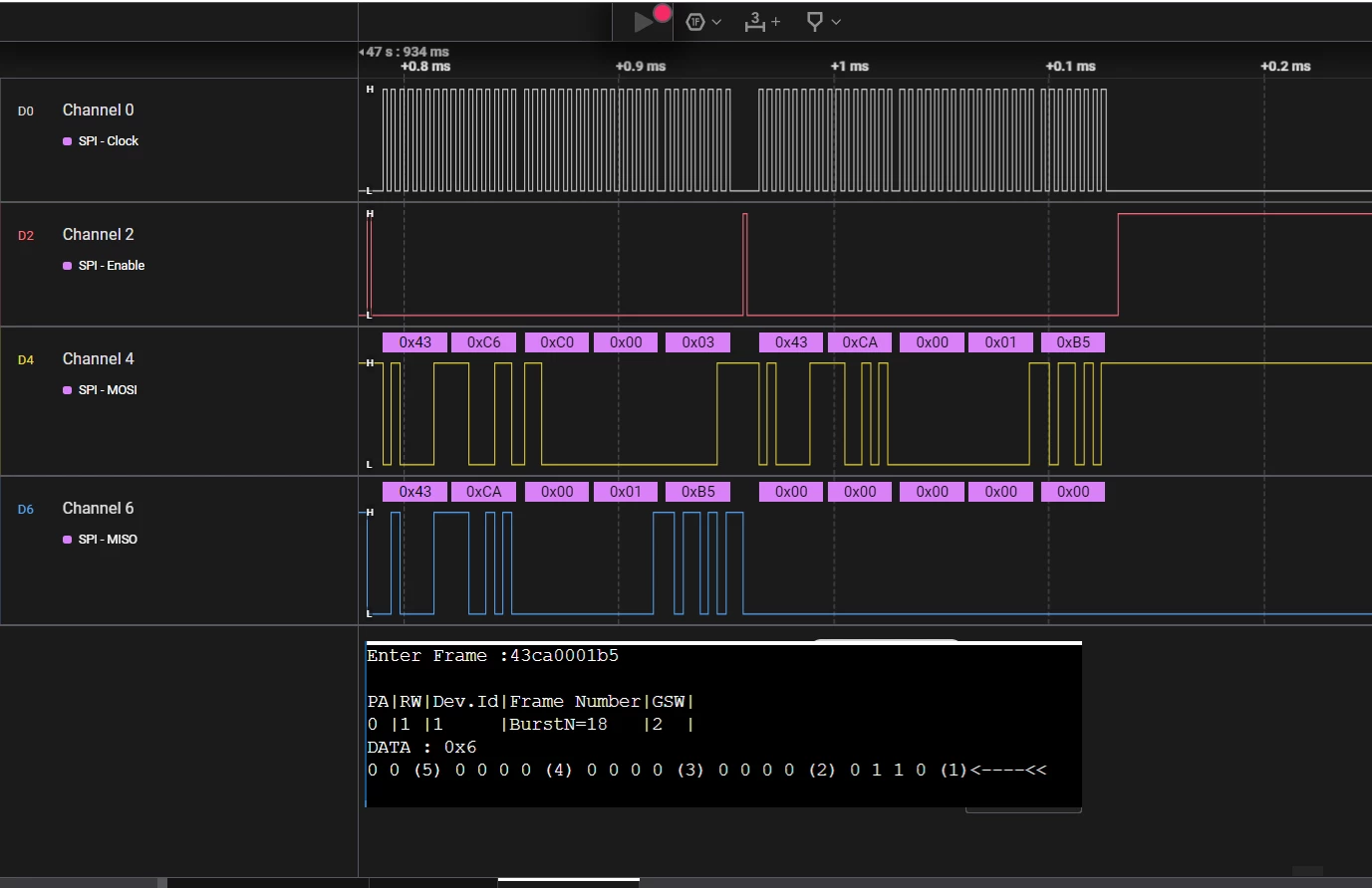

Dear Community members,
I have connected 2 node in ring configuration, and working on an custom pcb for BMS.
In registers Faults1, Fault_L_line_status is always 1, while all other fields of Faults1 and Faults2 registers are 0.
Also the OVRLATCH is not detected.
What could be cause to set 'Fault_L_line_status' 1 and where could I check to diagnose.
screenshot for expression view is added for reference for both nodes 1 and 2.
Regards,
bitBuddy

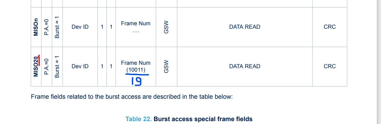

Oct 19, 2024 4:45 AM UTC
Hi Max,
In L9963E data sheet, in Table 21 MISO2 where frame no. is 2 (0b10), is this referring to burst response frame no. 1 in Table 24, 25, 26 ?
Max VIZZINI
Oct 22, 2024 8:47 AM UTC
The answer is Yes.
Best Regards,
AutoDevKit Team
bitBuddyAuthor
Oct 23, 2024 5:12 AM UTC
Hi Max,
seems it is a documentation error.
with regards,
bitBuddy

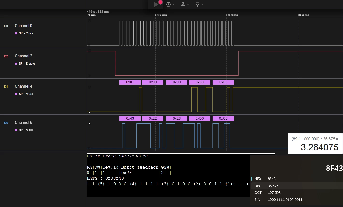

Nov 7, 2024 8:46 AM UTC
Hi Max,
As per observation in logic analyser, in burst(0x78) command feedback frame(MISO1 in table 21), data field is for frame 1 of Table.24 and burst response frame MISO2(in table 21) where frame no. is 2 (0b10) referring to frame 2 of table 24.
Hence we get max of 18 frame (MISO18 : Frame Num-18 (10010) in table 21) .
Regards,
bitBuddy
