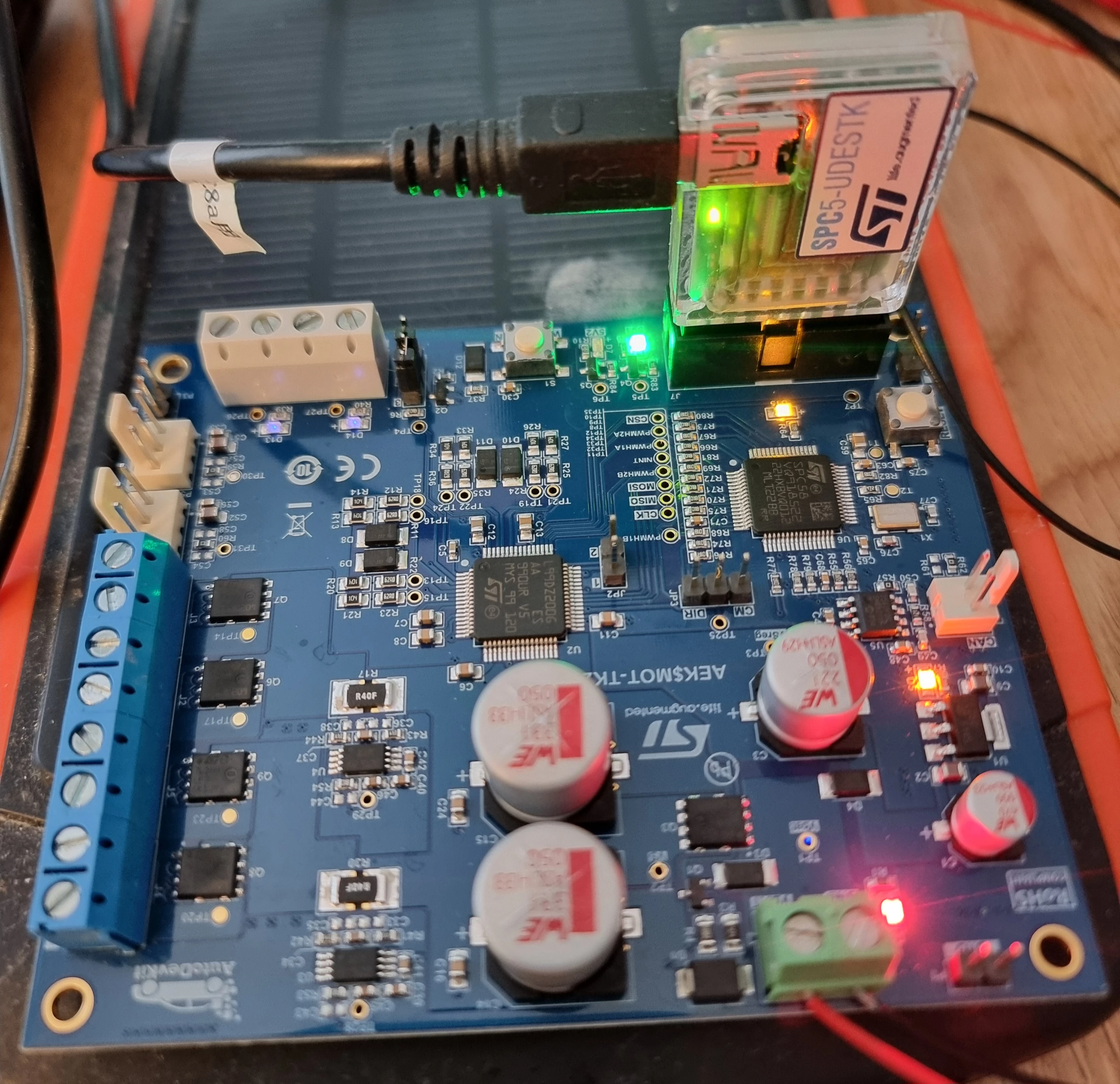

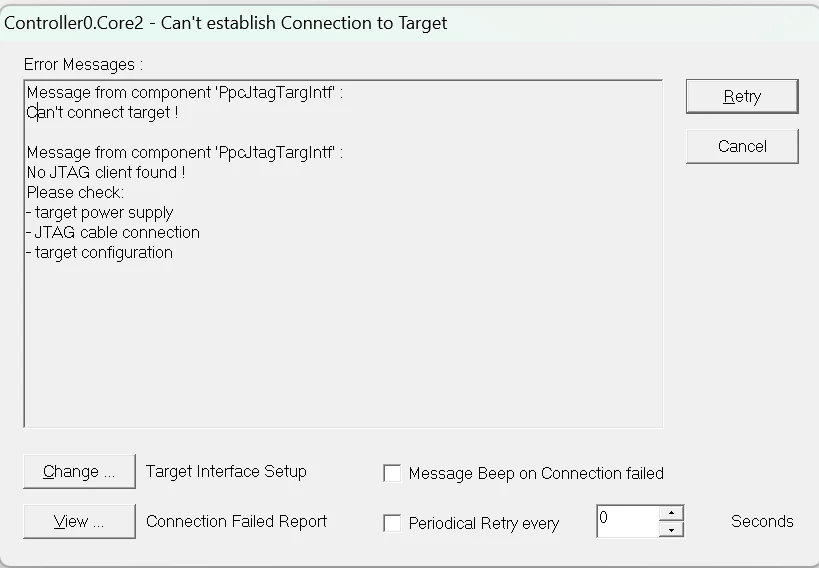

I have been trying to connect to the AEK-MOT-TK200G1 using a SPC5-UDESTK.
I tried UDE starter kit 5.02.04, and UDE starter kit 2021.05.
I'm getting the following error: (Message from component 'PpcJtagTargIntf' :Can't connect target !)
I have checked all drivers and versions but I still get the same error.

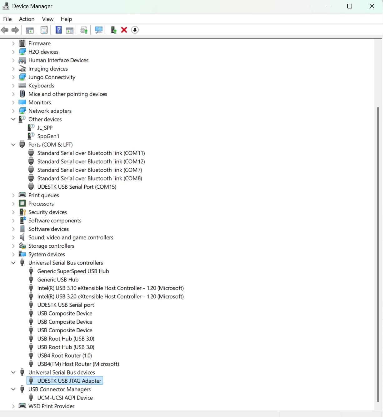

Here is my device manager:
I ran out of ideas of what to try next.
Has anyone got this setup working?

Feb 9, 2025 4:42 PM UTC
Did you put the board in SW debug mode?
Check User Manual UM2995 at paragraph 3.5
 https://www.st.com/resource/en/user_manual/um2995-getting-started-with-the-aekmottk200g1-evaluation-board-for-car-opening-closing-systems-stmicroelectronics.pdf

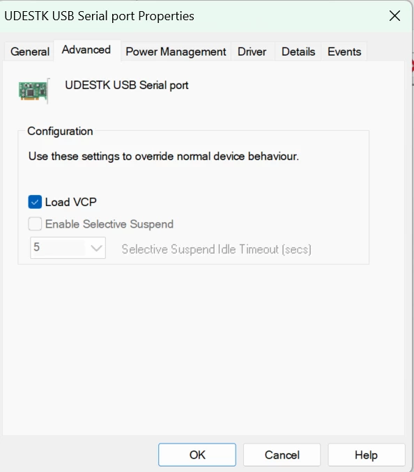

pivicAuthor
Feb 9, 2025 6:56 PM UTC
Thank you for your reply.
I have tried all the suggestions.
1. I placed JP2, applied power, removed JP2, connected the SPC5-UDESTK -> same error.
2. I watched the video, and that is what I'm doing. I also have the AEK MCU board, and connecting to the onboard debugger works fine. But it doesn't work when I use the SPC5-UDESTK to the AEK-MOT-TK200G1 board.
3. I uninstalled the drivers and reinstalled them -> same error.
I don't know what else I can try..
Thanks,
Alex
pivicAuthor
Feb 10, 2025 6:17 PM UTC
Out of nowhere, today it worked on both computers that I was using...
Without changing anything on them, it suddenly worked. I can now flash the board and step by step the code.
I don't know what was wrong before.
Thanks for your help,
