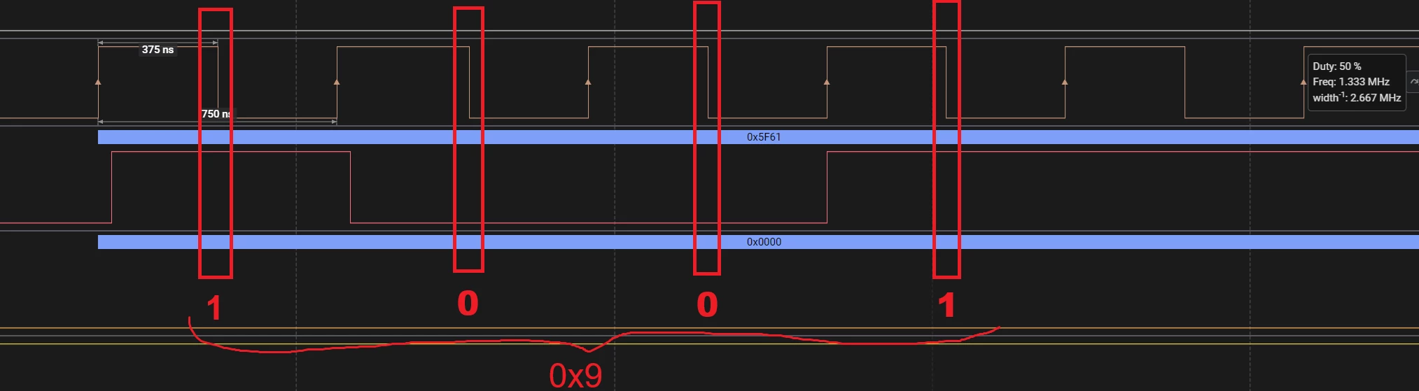

As I see from this screen:
you are decoding your SPI data on CLK Rising edge (which is wrong)
In this specific example, if you decode on CLK Falling edge, the decoded data will be the following:
SRomeo_1-1756981958018.pngSo, based on what you expect, you should adjust the configuration of your analyzer.
There seems to be no problems on the signals whatsoever.
I suggest you to check also the SPI configuration of your micro board, making sure data decoding are consistent

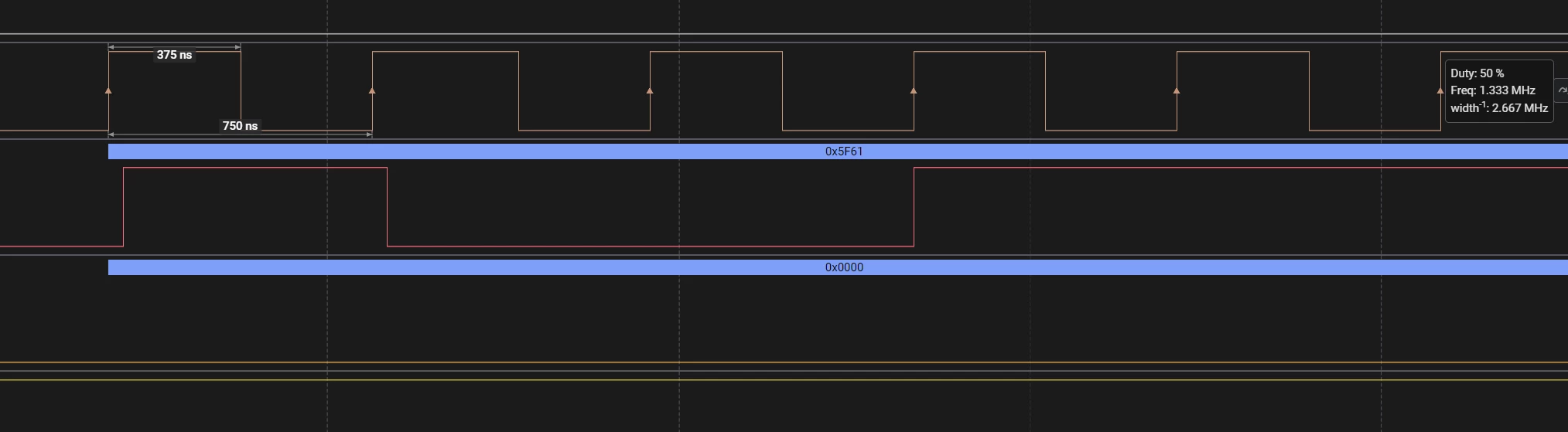

Sep 4, 2025 11:48 AM UTC
Thank you Ozone for suggestion.
Tried with lowest baudrate and problem persist.
Made some measurements with logic analyzer, see attachment.
ISOfreq=0
SPI clock to 250kHz
Best regards
Frank
