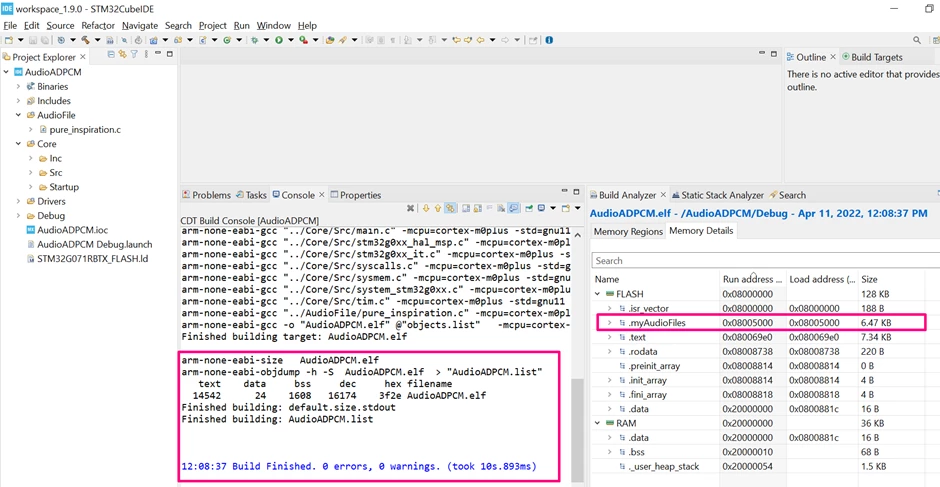

Now you have all the steps prepared and you can build your application by pressing “Ctrl+B”. You should see 0 errors and 0 warnings and in the memory details you should have the .myAudioFiles with the size of your audio file:
Assuming you have your hardware ready and properly connected, you can load the program in the STM32 and play with your audio file! You can add as many audio files your memory can withstand by repeating the process shown in this article
